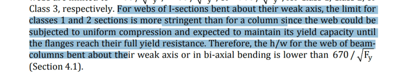

You might find this explanation useful:
Indeed I do, thanks for sharing that. I took a quick look at that just now. We're in agreement that kind of supports my previous hypothesis, correct?
