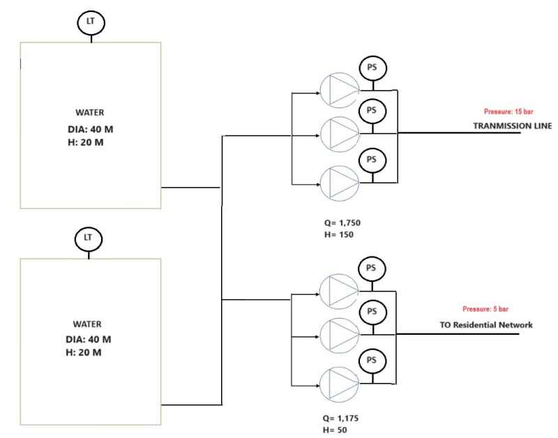

Dear @georgeverghese
Thank you for your reply, I attached the sketch
and here is the reply
Show us a process sketch which shows how this pump is controlled:
Pump use VFD.
Level Transmitter and Pressure switch signals used to stop the Pump.

So the VFDs' on each of these 2 systems is operated by a dedicated master pressure controller sitting some where on pump discharge ? Presumably residential master PIC is set at 5barg, while master PIC for transmission line is set at 15barg. And the VFD on each pump may be operating on one of 3 speed ranges reset by PIC output ?
Are you sure these pressure switches are meant for safety overpressure protection ? Or are they in dual service as process control devices cutting out relevant pump as line pressure increases during low flow demand ? If this latter is the case, then
[And the VFD on each pump may be operating on one of 3 speed ranges reset by PIC output ?] wont be necessary
Which is it ? Has some one prepared the process control narratives for these 2 systems, where you will find the answers to these.

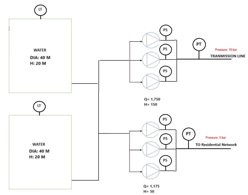

Pressure switch is working for safety overpressure protection only, because there is PT on the main line to adjust the VFD (attach new schematic)
VFD is adjusted to work on 4.5 bar.
I was going to use API 610 and set the pressure switch on the shut-off pressure of the pump or little bit, what is your opinion ?
Okay, so these are to protect the pump in case of blocked in flow potentially going up to dead head operation.
Since you have a variable suction static suction head ( head in feed tank varying up to 18m), would suggest using a differential pressure switch dPSH ( dP between pump suction and pump discharge ) rather than discharge pressure switch. Set the dP to that equivalent to the head developed at min flow for each of these 2 sets of pumps.
So for the transmission set, if head developed at min flow is say 170m at max normal speed, then set the dPSH at 17bar. This assumes that in the worst case, when pump discharge pressure = 17 + 1.8 = 18.8barg, that piping design pressure can still handle this pressure. Check the Q-h curve for this pump set to see what the head is at min flow at max normal speed.
In this case, you also need to check that water hammer pressure does not exceed 1.1x to 1.3x piping design pressure, if water hammer can occur.
For the residential set, use the same approach.
Zuma,
You're answering your own question here.
If VFD for the 5 bar system is set at 4.5 bar, then set your pressure trip to 5 bar ( or if you want to be a bit cautious to avoid spurious trips set it to 5.5 or 6 bar)
I assume therefore you set the higher pressure VFD control to 14 bar?
Then set your pressure trip to 15 or 16 bar.
Why is the system set to 5 bar and 15 bar? Find out that and all will become clearer. e.g. are there any relief valves anywhere? What is the lowest actual pressure rating of anything in the downstream system?
Either way I would also add into the shutdown circuit a timer function to reduce the potential for spurious trips caused by a sudden spike in pressure.
A time period of 5 or 10 seconds should be enough to smooth out any transient pressure spikes as when the pumps come on and off line or ramp up from the VFD control and overshoot a little bit.
If you don't the operators will either tweak the setting higher or disconnect it...
For both pump sets, add PSH on pump discharge also. dPSH setting is not fixed, it should be speed compensated.
For transmission line pump set, what is the max permissible operating pressure of this piping system (MOP) for the material and pipe class you've got. Set PSH at 90 % of this value, and also add a PSV at MAWP if pump deadhead pressure with tank at 18m can exceed MAWP.
For residential pump set, setting the PSH at 90 % of MOP may be too high. Say 7-8barg. Pump set may be incapable of breaching the MAWP of the piping system, so PSV not required.
