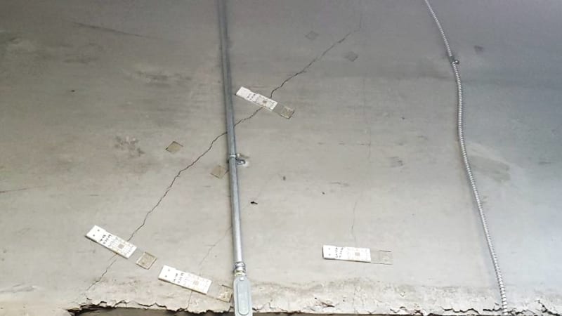

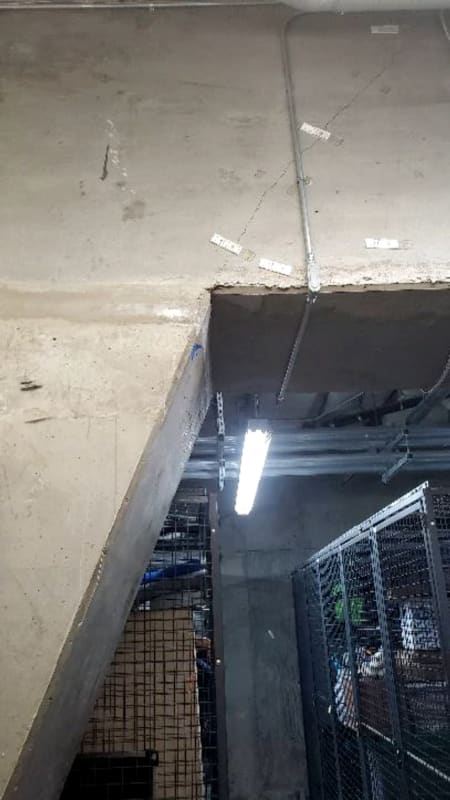

I was looking at some photos of an SGH inspection of the tower & podium last week and came across this gem. It is the southeast sloping SMRF. The main crack seems odd because it is open in the middle and closed on both ends. Is it a torsion crack? The image is taken looking to the south. This SMRF is about 4 feet from the edge of the hinged 3 ft. cantilever mat.
That's certainly an interesting crack pattern and something it seems that the structural people would be very concerned about. Not sure what the cause of being but it sounds like your idea of being torsion is quite logical. It will begin to see if this is brought up again and is a subject of any further study.
The crack(s) seem to be in a surface application of "somethin'", about a half inch thick, smeared over the concrete. Look towards the bottom of the beam, in the lower of the two photos. That SURELY isn't what's left after the forms are removed.
So maybe it's a shrinkage crack in the "somethin'". Or maybe there's an even bigger crack in the actual concrete hidden underneath.
Or there's nothing to see here--move along, please.

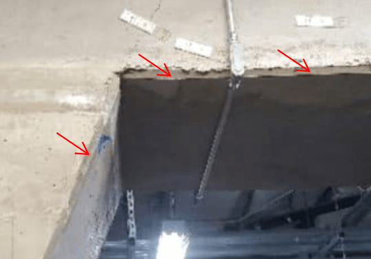

No, that is off-form concrete finish. The 'dags' you see at the bottom are where concrete slurry leaked behind the chamfer strip and was not removed after the forms were taken off.
I would have thought the SMRFs would be located on the same plane, not slightly offset. Is there a reason for that? ductility?
"...off-form concrete finish."
Why would they smear this stuff? It can't be structural, can it? And, if not, what's the point?
spsalso
Is it NOT a coating or a 'smearing' of cementitious layer.
A 1" x 1" (or 3/4" x 3/4") wood chamfer strip is added to the corner of the beam/column forms, and when concrete is been placed and consolidated the chamfer strip often moves slightly (if the chamfer is not nailed securely) and concrete slurry then gets between the chamfer and the face of the formply and then the concrete and slurry sets. Upon stripping the forms the 'dags' remain. Hence, an off-form finsh, no coating.
Could it be a flexural crack from moment caused by vertical translation?
Crack inclination signals a Shear crack. Flexural cracking would be more vertical at Top & Bottom extremes.
Got it about the leakage behind the chamfer strip. Thanks.
spsalso
Sorry Ahmed, the cracks are nearly vertical, and there are 2 or 3 of them, similar to a flexural crack in a high moment area... it was just a thought.

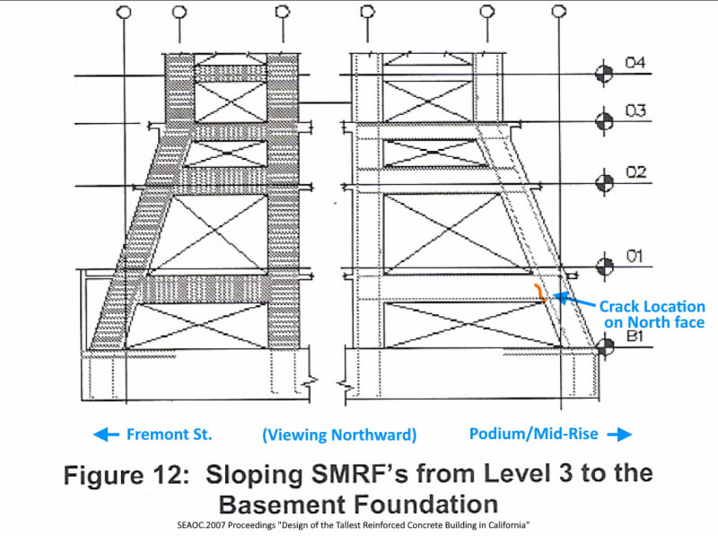

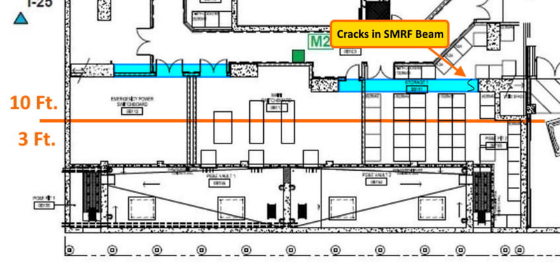

Can any of you structural guys explain to me how the Baugrid connects at a joint like this? I checked their website and it looks cute in a beam or a column, but what do they do at connections?
The slope of the most southeast & most southwest SMRF are the result of needing 'driving' space for vehicle in the porte-cochère.
During peer review it was an element to which Hardip Pannu of Middlebrooke-Louie, noted a concern for the large elements behaving like shear walls. There isn't any information as to how his concern was resolved.
EOR, Derrick Roorda at that time with DeSimone Consulting Engineers, wrote in his paper for the SEAONC 2007 conference proceedings; "Design of Tallest Reinforced Concrete Structure in California – 58 Story Residential Tower in San Francisco" as so:
