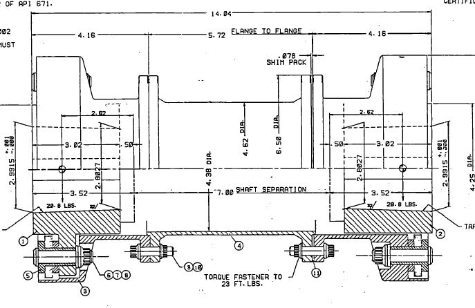

Is it possible to mount the shaft alignment sensor on the flexible hub (but in locked position) ?Will it affect the readings?
Is it possible to mount the shaft alignment sensor on the taper shaft ?Will it affect the readings?
I would say no, unless you could verify the blocks rendered rigidity in the flexible joints. Are you sure that the flanges with arrow markers are not a rigid part of the shaft hubs? Can you show a cut-away drawing?

We have this style of coupling in a few of our larger centrifugal compressors. We have mounted the lasers to the shrouds, as you proposed, with the center spacer removed and the shipping screws locked in place to prevent flexing. You have to be very careful, but this can be done. On others, we have used a stud threaded into a hole in the center of the shaft to mount the laser on one or both sides. You can mount the laser on the tapered shaft end with the hubs removed, but this is a lot of extra work to remove and reinstall the hubs. I would usually prefer the first method I described. Mounting to the taper would concern me about any damage to the hub contact area.

I would mount laser brackets with magnets or adhesive onto rigid hub faces labeled 1 and 2 in drawing. I would not try to make coupling rigid for alignment measurements. You should be able to mount laser bracket on a tapered shaft. If you cannot adjust laser heads enough to compensate for the taper angle, then place some small shims under the bracket V-blocks to remove most of the taper angle; just keep mounting brackets rigid to shafts.

The main problem with rotating the shaft with a strap wrench is that the strap would have to be on the shroud or the center spacer. There is no place to mount the lasers other than the shroud. This requires that the center spacer must be removed. Otherwise, you would be checking alignment on a solid structure (perfect alignment every time). If the lasers are on the shrouds, I would not want to use the strap on the shrouds since any flex or movement relative to the shaft would invalidate the readings. Using the puller holes on the face of the hub with an adapter to rotate the shaft seems like a very good method.

The mounts for the lasers should be on the end parts that are locked to the shafts, not to the spacer that is attached by flex plates.
