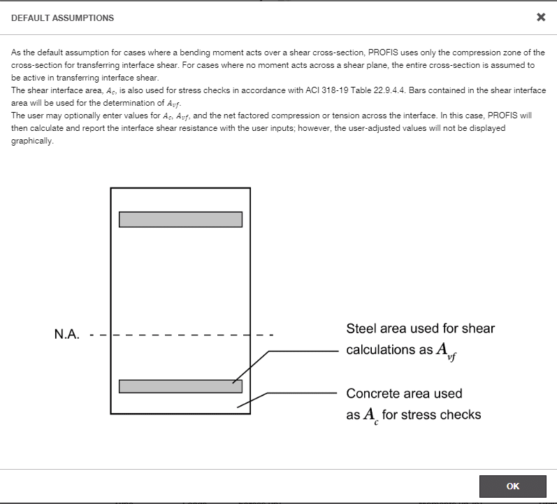

Hilti, which generally offers very sophisticated software, contradicts this argument as shown in the screen shot below.
This picture is from their slab extension software (shear friction) and not their standard dowel/concrete breakout software.
Hilti defines Ac as the compression block area, which in my opinion is not necessary as per ACI.

CDLD: I'm hoping I attached correctly the picture I took of the example. There are a couple of things about Hilti that bothers me when it comes to how it handles shear calculations. Their shear calcs are a little different compared to what ACI says to do for:

At least their calcs are more conservative for the above three scenarios but I'm not surprised that for shear friction they do something different as well. At least for those calcs they are more transparent about it in their software inputs. For the other three I had do go through their calculation report to find the discrepancies.

Also, that particular Hilti example isn't that for a slab splice?
