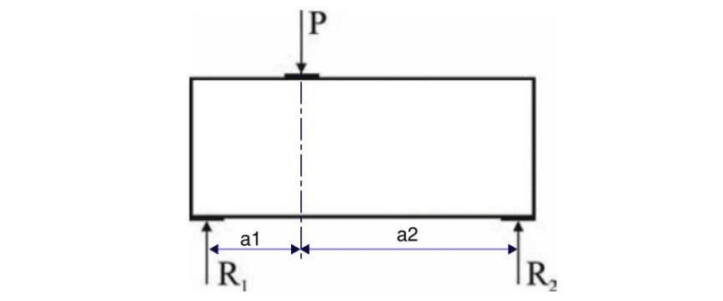

An example response from the web:
Shear span is the distance from the point of application of concentrated force to its respective Reaction force (supporting column).
Throughout single Shear Span the Shear Force is constant, i.e. have same value of Shear Force throughout a single Shear Span. There might be multiple (varying) shear span for a single Beam depending upon number & position of applied force to the numbers of supports.
Here, you can see a1 and a2 are the two different shear span for the same beam.

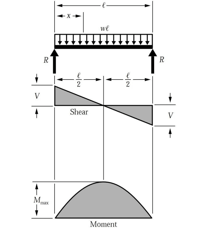

Example of shear span = 0:
Shear span is defined as the zone where shear force is constant.
Reference : “What is shear span?”
Typical bending moment and shear force diagram of uniformly loaded is beam is given below.
Since, shear force is not constant between any span within the beam. So, shear span is 0.

No one is suggesting that M/V = 0. For a simple beam with uniform load w, M = wx(l-x)/2 where x is the distance from the left support. There is no shear span because there is no portion of the span where shear is constant.
A beam loaded with two point loads 'P' each applied at 'a' from each end has a shear span of 'a', a reaction of P, a moment varying linearly from reaction to load point and a constant moment P*a between the applied loads.

For a uniform load on a simple beam, Mx = wx(l-x)/2 and Vx = w(l/2-x).
So Mx/Vx = x(l-x)/(l-2x). Mx/Vx varies throughout the span, approaching infinity at midspan. Call it M/V if you wish, but it is certainly not the shear span.
