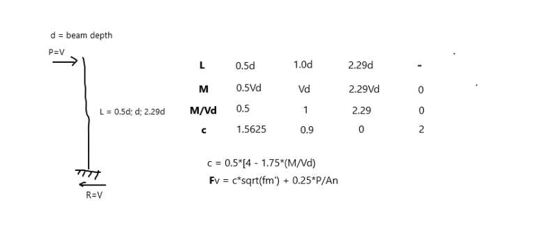

In an effort to understand the physical implication of the shear span ratio, I did a parameter study on the cantilever column as shown below. Ignoring the contribution of the compressive stress (second term in the shear strength equation), the things I've noticed are: 1) The shear strength decreases when the column span to depth ratio increases (L/d). 2) The shear strength diminishes to zero once nearing the upper limit of deep beam classification mentioned previously - 2.5. 3) The theoretical maximum shear strength occurs when M = 0, then Fv = 2*sqrt(fm'), which is identical to shear strength of the reinforced concrete members (note this case is not associated with the cantilever under study).
After all, I still don't understand why M/Vdv is set to 1.0, when larger ratio occurs. Any idea?
[After thought]
From exercise above, the physical meaning of shear span ratio can be expressed as below:
- The shear stress resistance at the cantilever wall base is anticipated to be the minimum, when the wall height (L) to wall in-plan depth (d) is greater than 1. The allowable stress increases when the ratio is less than 1.
- The moment influences the masonry shear resistance in a negative way. Unlike the reinforced concrete, which allows the additional shear capacity for the presence of reinforcing steel, that provide better confinement - an effect similar to the term P/An.
