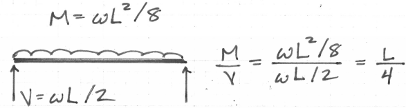

M/Vd is a unitless expression like KL/r. It is intended to be computed.
If shear span, defined as M/V, is analogous to effective length, KL, then the shear span of a simply supported beam is L/4.

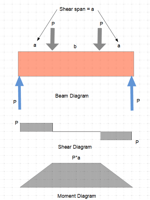

Two concentrated loads symmetrically placed on beam.

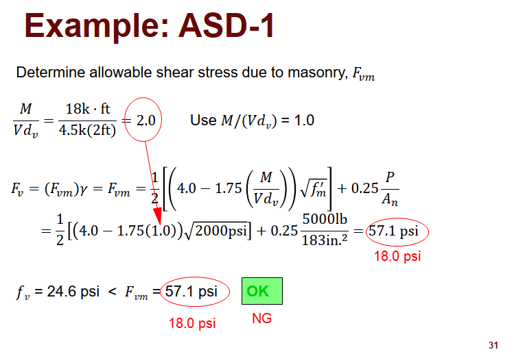

I found something from the Masonry Society. The equations for shear design and allowable stress are listed on p.19-20. Also, there is an example utilizing M/(V*dv to determine Fv. I don't think this document answers your question in direct manner, but it might help to read through the example with code by your side. Link
BAretired and KtootK,
After a quick glance into the paper I linked, my impression is the term M/(V*dv), or shear span ratio, is used in equation to determine the allowable shear stress of a plane in a cantilever masonry wall (maybe valid for simply supported wall as well). M and V are the calculated forces on that plane, and dv is the length of that plane in direction of the shear force (beam depth). The limiting shear span ratio was determined by researches, and is best kept at less than or equal to 1.0, to minimize the allowable stress, though the ratio could be much higher than 1.0. The design method is ASD based, so the conservativism. I am not a masonry guy, if I made mistake, please advise. Thanks.
I do not think I agree with your conclusion. If the value of M/(V*dv) is permitted to be greater than 1.0, the expression for Fvm would be reduced, not increased (see below).
Fvm = 0.5[4.0-1.75(M/(V.dv))].sqrt(f'm)+0.25(P/An).
BA
BA,
Yes, agreed. [purpleface]
As a matter of fact, if we take the calculated value of 2.0 for M/Vdv, fv is greater than Fvm (see below).
BA
Some interesting notes.
- ACI concrete shear equation, note the familiar term Vu*d/Mu.
This shear strength may also be computed by the more detailed calculation for members subject to shear and flexure only:
Vc = 1.9*sqrt(f'c)*bw*d + 2500*ρw*Vu*d/Mu
....., Vu*d/Mu should not be taken greater than 1.0, and Mu is the factored moment occurring simultaneously with Vu at the section under evaluation.
The shear strength of deep beams is predominantly controlled by the effect of shear stress. These beams have a small shear span/depth ratio, a/d .... See Fig. 5 and Table No. 1 for classification of beams as a function of beam slenderness (Shear Span/Depth Ratio as a Measure of Slenderness).
Table No. 1 classifies the beams as:
a/d > 5.5 [Slender] - Failure mode: flexural
2.5 < a/d < 5.5 [Intermediate] - Failure mode: diagonal tension
1.0 < a/d < 2.5 [Deep] - Failure mode: shear compression
Any thinking, coimment?
