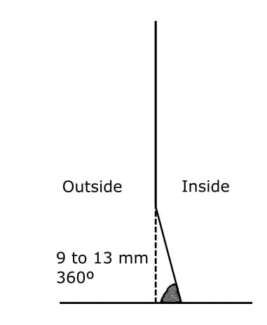

Hello,
in a repair of a tank the shell suffer a distortion in the connection to the bottom anular plate.
the distortion is 360º , 9 to 13 mm (1/2") to the inside.
I cannot find anything specific to this in API 653, to reference.
most similar is banding between shell limit to 13 mm (1/2") in 900 mm (35"), but it refers localizes and between shells.
what the effect of tensions in this área??
any ideas??

the deformation stars more or less 270 mm from the bottom.
roundness cannot aply because meausure is above 1 feet (out of the affected area)
plumbness from astm limits 28 mm, but aproving a deformation in the last part of the shell near the critical zone semms nonsense.

Deviation angle is 3degr. as per information. If we assume 13 mm horizontal deviation, plastic hinge height will be ; h=13/ TAN(3deg) =250 mm and plastic strain will be 5.5 % . (acceptable strains typically 2 percent - 3 percent)
The answer may vary as per your position . My personnel answer will be, if i were the consultant or client , i would reject and ask for fixing the shell.

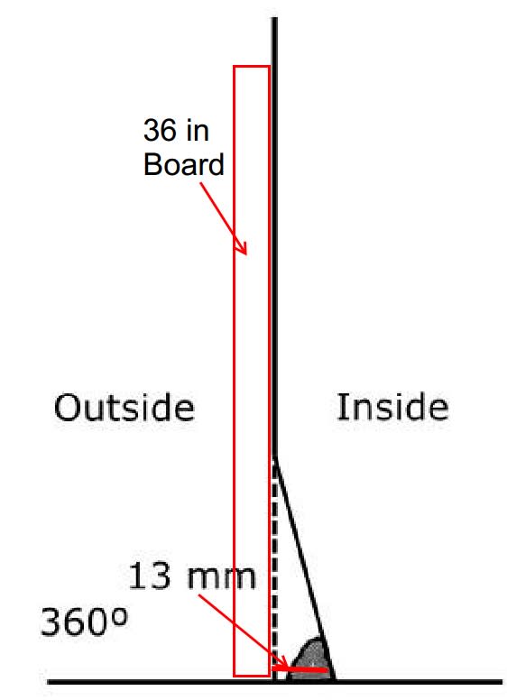

my question is the tolerance of acceptance.
In API 653 i dont find any indication about tolerances of acceptance of deviation of shell to bottom weld.
The FFS (API 579) is running in parallel.
Banding i understand it´s not the best criteria.
the deformation stars more of less 270 mm from the bottom, using the board 36 in (900 mm) i reach the 13 mm deviation
how can i ask to cut, remove distortion of shell if i dont have support in API 653??

Why would a plate bend at 270 mm above the floor ? - if it is distortion from welding the base plate the whole first course shell plate should have pulled inwards at the bottom.
If the contractor has cut the shell to base plate and then just rewelded it in the location it sat (without jacking / pushing it out to original diameter) it would explain the 13 mm all around problem.
The first course to second course weld has possibly caused tension/shrinkage in the weld so that when the shell to bottom plate is cut the tension is released and the plate pulls inwards - still doesn't explain the 270 mm location of distortion.

As you have stated there is nothing in the codes to help you - the only thing you can possibly query is why a 19510 mm diameter tank is now 19484 mm diameter at the base.
