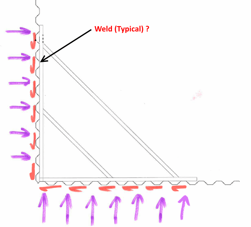

Hi everyone,
At the company I work for (design and construct shoring wall contractor) it is common to implement a corner brace for , say, a sheet pile wall.
Analyzing the system in 2d is simple: prop forces, embedment, wall forces etc. However I cannot find any guidance on how to resolve the load transferred into the the 'shear wall'.
The more senior people designing this also have no idea either - just that "it cant fail like that".
Any ideas/comment?

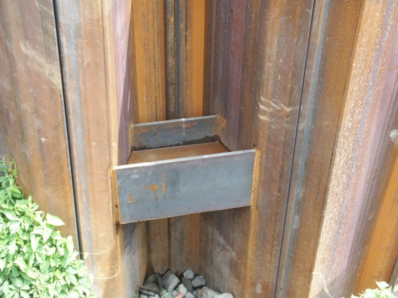

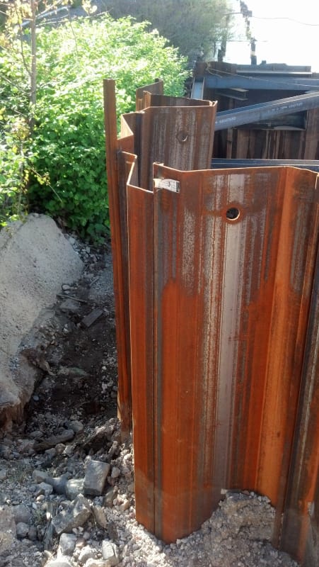

While there may be more than one way to look at this problem, I don't believe that there is a good or totally correct way. The key is to be conservative when figuring out how far to run bracing wales from the corner. I had a cofferdam where the wales needed to be terminated about 60' from the corner before transitioning to tieback anchors. The wales needed to be terminated because they would have interfered with abutting concrete walls with architectural finish. Unfortunately, the SSP squashed at the end of each wale, but just before the tiedback SSP began. The inserted photos show (but not well) the areas where the sheet pile doubles were squashed along the length of the walls. One photo shows how we needed to install some welded steel beams to prevent further squashing of the SSP. A similar situation was also a major contributing factor to a significant, braced, soldier beam wall collapse in Washington, DC back around 1990. Don't stop the wales too close to the corner.

JSD - Yes, I answered a different question that what you asked. Just not paying attention. Your question is more difficult.
If you carried the walers / stiffeners horizontally all the way to the far side (full length), then the passive resistance (and/or at-rest soil demand) will resist (some of) the in-plane forces. That is, "around the corner" at the far end of the box, there is resistance normal to the applied load in question.
However, what is the interface shear strength between the fluted sheets and the soil, given the installation tolerances (potential semi-contact in the upper soils)? High variability, depending on soil type, depth, depth of flutes...

Follow-up to my previous response: This link takes you to the OSHA report on the 1990 Washington, DC sheeting wall collapse. Page 48, Section 4.1.2 describes how the soldier beams were not capable of resisting the thrust that came along the walls from the perpendicular, end, sheeting wall. It is hard to accurately estimate (or easy to overestimate) the resistance of a sheeting wall when supporting an axially loaded wale. As I said previously, this was a contributing cause of failure, not the only cause.
SlideRuleEra -typical weld is 150mm weld top and bottom of waler to each sheet at 750ctrs, weld is 6mm continuous fillet weld. so each sheet pile is very well connected to the waler.

If I had to calculate it, it would be like this.

SlideRuleEra - the above was just a random depiction - however by raising the brace level the brace load would be less but I believe creates more issue as the distance between the centroid of the shear resistance to the strut load increases and induces overturning to the whole system.
