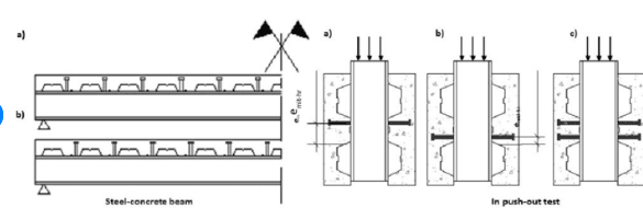

I wonder if a testing company could set up a pushout test. That's how one would verify the capacity of the studs in a research program. These specimens are pretty small and the testing procedure isn't difficult.
Mentioned in the following, among many other places.
Pushout tests, in some statistically meaningful quantity, surely would be the by the book way to do the testing. I just struggle to imagine a contractor being willing to do that mid-stream on a live project. I'm guessing they'd prefer new studs.
