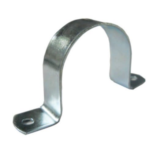

1. The connector is a clamp, something like the picture
It hold two parts under two type of loading... one is vibration profile, another one is acceleration in mini second - shock
I was wondering if HCF is a concern and then using Goodman diagram for the check?
Mean stress will be collected from vibration load profile and alternating stress will be from acceleration loading.
Does it make sense to you?

I am surprised that this U-clip is attracting such attention. If vibration loading, would an isolator help ?
