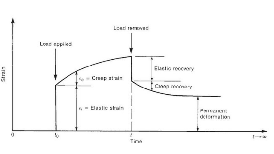

The method for calculation of deflection of reinforced concrete structure is still unsettled. An interesting graph of strain vs time is provided below for the curios minds.
Retired13
Not sure how that diagram helps anyone. Yes, there is partial creep recovery when load is removed. That is why creep and shrinkage effects are calculated for permanent load, not maximum load in most cases.
