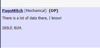

1503-44 - No disrespect meant, but I provided the length both in my original post as well as my response:
265 linear feet/ 81 meters.

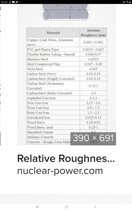

Our differences in Epsilon are also significant. I have used 0.0025 for a long time... so long that I cannot recollect or find a reference. But here is a very similar value from the "Engineering Fundamentals" (eFunda) site, using 0.0015mm. But a long way from 0.035mm.

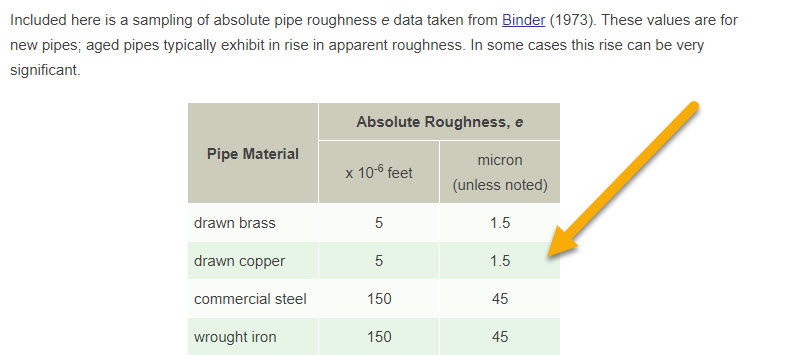

I thought roughness of tubing is 0.0005 in x 25mm/in = 0.0125mm, then I used something else.[ponder]
It's very, very late here and Steel is permanently embedded in my brain.
These are the values of roughness that I have used for the last 100 yrs. Below.
Copper 0.0015mm
Slick epoxy coating at 0.0001" = 0.0025mm
At least things seem to be converging.

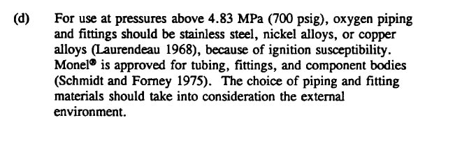

Why not use Monel 400 or Cu-Ni 90-10(?),You will have a stronger tubing material with the same exemption pressure of 20,6 MPa (3000 psi), completely voiding the velocity limitations in both impingement and non-impingement sites and allowing for a smaller tube ID, allowing for more common fittings to be used.

I am really curious about when the properties of SS in oxygen changed.
In 1966 DMIC Report 224 " At lower temperatures, the 300 series stainless steels do not ignite when ruptured in 2000psi oxygen at 572F."
Considering that in commercial aircraft the high-pressure oxygen bottles are nearly all SS (usually 21-6-9, Nitonic 40) and these operate at 3,000-10,000psi depending on the application.
Not to hijack the thread, but it hasnt.
Ever since Union Cabride Industrial Gases inc.got renamed to Praxair they started putting a lot more focus on gas safety, to the extreme (In large part due to the Bhopal accident). It is a reason Praxair gs-38 was one of (if not THE most) strictest degreasing standards, and is often followed even today. When they merged with Linde plc in 2020 thats when the focus on the use of stainless steel in oxygen service really became a primary focus.
I will not be surprised if they want to completely phase out SS within the next 5- years. Guess we will find out

EdStainless/Prometheus21 - Re: use of SS. I am just the dumb designer. When the applicable Code state that Copper has an exemption pressure of 3000 psi, and 316SS has an exemption pressure of 325 psi, and I am at 1500 psi, there is no question on my decision. Wish I could reconcile others' long term use of SS for high pressure O2; but that is not my job...I have been involved with (2) court cases in my 40 years practicing. Both were favorable to our firm; and both came down to "What Codes did you follow when you designed this?". Both were also experiences I would rather not go thru again.

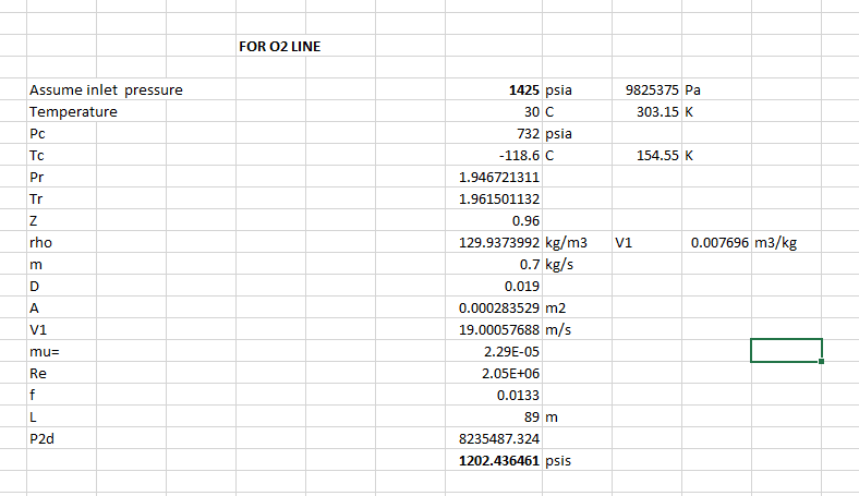

Hi pierreick,
Thank you for your observations. I was a little lazy in not going through all the threads.
I have recalculated based on updated data as available and which as given below after several iterations.
The required inlet pressure is 1425 psia. But it is very sensitive to actual ID of tubes..
Hope the above information will be of some use.
