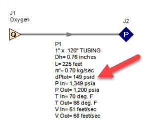

Interestingly enough, we had Swagelok go thru about a dozen gases in this system; they are providing the manifolds and regulators.
For the O2, they came up with 149 PSIG.
For this project, this is now pretty much academic, as we will just be adjusting the regulator to get the desired result.
At 225ft of 0.76in id tubing, I get a developed backpressure of 1355psig with an exit press of 1200psig, so dp = 155psi.
Even though this has become an academic exercise, it is interesting to investigate why Swagelok would get such a different Delta P from the 220 psi that the rest of us got. It is all about the input data. Here are the principle differences
Pipe ID: Swagelok = 0.76"
Rest of us = 0.742" (18.85 mm)​
Pipe Length: Swagelok = 225'
Rest of us = 266' (81 m)​
Temp in: Swagelok = 70 F
Rest of us = 100 F (38 C)​
Swagelok have not specified the pipe roughness that they used. Most likely they would have used the normally accepted value for drawn piping of 0.0015 mm and not the 0.0025 mm given in the thread.
Using the Swagelok values gives almost exactly 149 psi in the standard isothermal model. They have shown a small temperature drop between inlet and outlet, indicating that they have used the adiabatic model. Under the given conditions the two models should give very similar results.

Agree with Harvey about the calculation using the Adiabatic model. Not sure why Swagelok choses it, long tube, no insulation.
