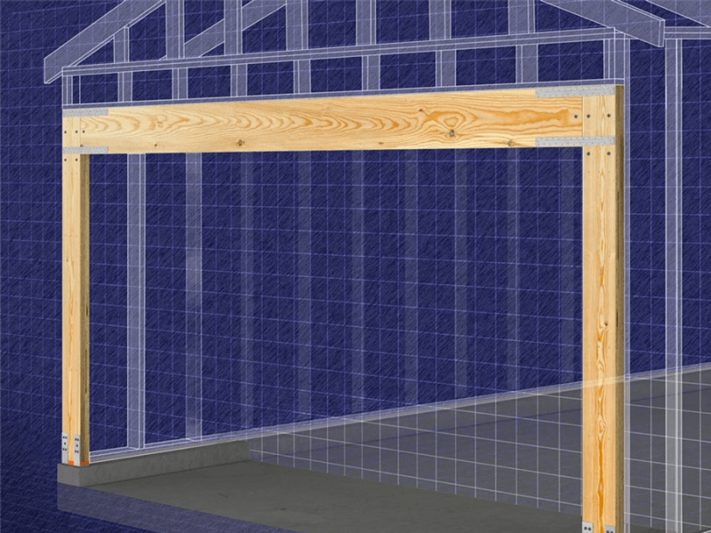

Does anyone know if a strong wall can be used as a true portal frame? My impression from Strong Wall literature is that it will provide the "equivalent" braced wall requirements per the IRC.
My situation is different, I need to provide a true portal frame where load delivered to the frame comes from a single load at the outside corner of the frame. As in, the top of my portal (along the beam length) is not collecting or dragging loads as you would see along a braced wall line.
I cannot figure out how to actually design one of these frames using the Simpson resources. Any suggestions?
The beam over the top is still dragging the load to the other side of the portal frame. I don't see this being any different than just regular strong wall design.
Unless you are trying to use the flexural stiffness of the beam it seems like just two shear panels with a drag beam over the top to me?
Here in the UK they make two different products - A strong wall which is just an equivalent shear wall on its own and a Strong Portal which connects two of these over an opening with a significant timber header beam that does provide portal action and is moment connected at the tops of the shear walls.

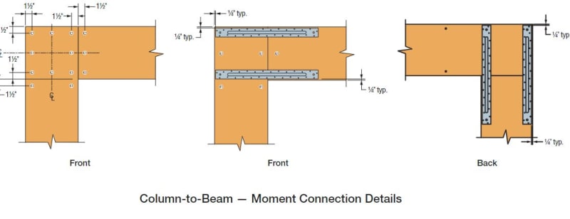

A picture might help here, as I am confused as well. Wood portal frames typically have a tested moment capacity that is codified where the beam frames overtop the vertical shear wall element. This is achieved by a large collection of nails into both the shear wall element and the beam element to provide rigidity. Not sure how you would attach the nailing directly into the face of the strong wall, isn't there steel hardware preventing this?

What makes you say that? The beam to column connections sure look like moment connections. And they call them moment connections in their technical literature.

I agree with you, it's certainly is detailed to look like a moment connection and they call those straps you see "Moment Connection Straps"

I'd bet a thumb that these thing are, in fact, real portal frames.
