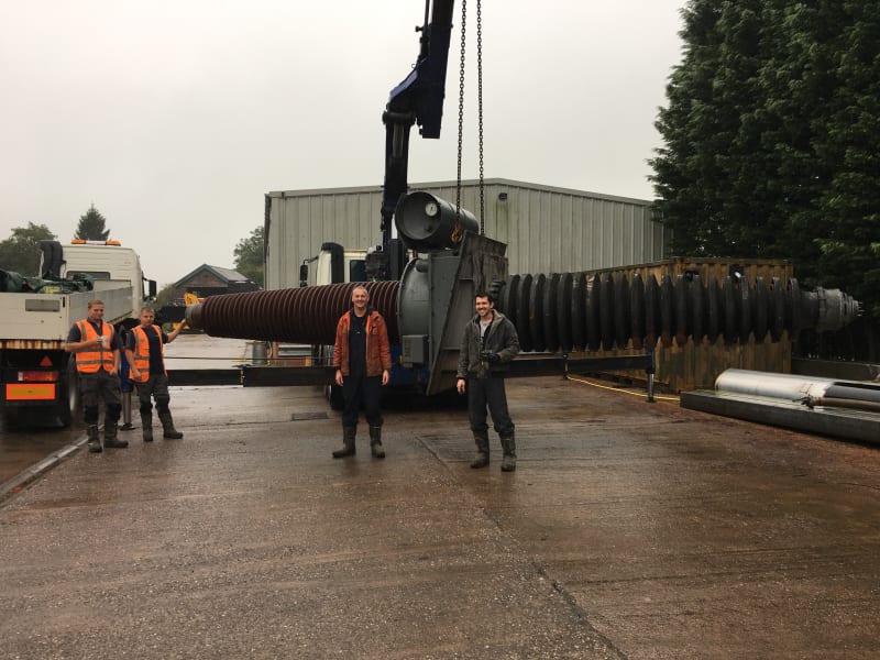

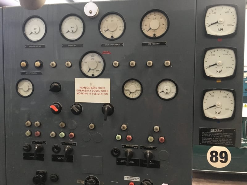

Nice little problem for you al1!
We have a 1965 British built by W H allen v16 large generating set that has just been saved for preservation. The complete set up is in very good condition having only done about 2600 hours. We have the complete contents of the generator building to include all the switchgear etc. This engine represents a British engine manufacturer and a early type of large packaged generator.
it also has open rocker gear which will be very nice to watch.
The alternator is a brushless type with the supply for the AVR being picked up via a 6.6kv/110volt voltage transformer. There must be an element of self exciting on start up?
The alternator was wired in star with the centre point earthed via a neutral resistor which we were unable to obtain due to asbestos content within the resistors housing.
The alternator details are
1666kva
1333kw
rpm 750
power factor 0.8
volts 6600
amps 145.7
Brushless a.c exciter details
kw (dc) 16.45
volts (dc) 82
amps (dc) 201
poles 6
3 phase
frequency 37.5
full load exciter ac voltage 49.4
ac current 6.13
rectifier connection. 3 phase bridge.
The engine is in perfect condition and within a few months this will be back fully operational after reconnecting the shut downs and control circuits which have been a total joy to work on due to their age.
I fully appreciate it is both impractical and unsafe to even think about returning the alternator to service plus to have the ability to load up this engine with a load bank, the resources involved and expenditure would be too great.
But...........
It would be good however, to place a load on this engine even if it is nowhere near to the full capacity of the alternator.
So here is the question: Thinking outside of the box do any of you think this alternator could be wired to give some sort of load.....such as windings shorted, d.c injection etc etc. basically anything that will cause a load to the prime mover without having to generate at the full voltage. I suppose the major problem is the flc current, as we reduce the voltage to a safe level the 145 odd amps on a 2000 hp diesel engine, it wont even know it is there! but I do not know about any other methods that could be used that are either used for testing purposes or a alternative radical approach.
Any ideas or do you think it is impractical and wont actually generate any sort of engine load,
I have attached some pictures of the generator that was saved, ironically from Astra Zenica early last year. Little did we know what was about to come.
Cheers
M
ark

Interesting project!
Did you get the radiator or cooling tower as well? The you need fuel and lube oil tanks and all the pipework, exhaust silencer etc? You seem to have the airstart system, as I can see the cylinder on the far side of the engine.
Where is it being installed?
The generator (correct term for alternator) is AEI. They were at Mill Road Rugby and were integrated into UK General Electric Company (no connection to the US company) in the late 1960's after Arnold Weinstock's amalgamation of GEC, English Electric and AEI.

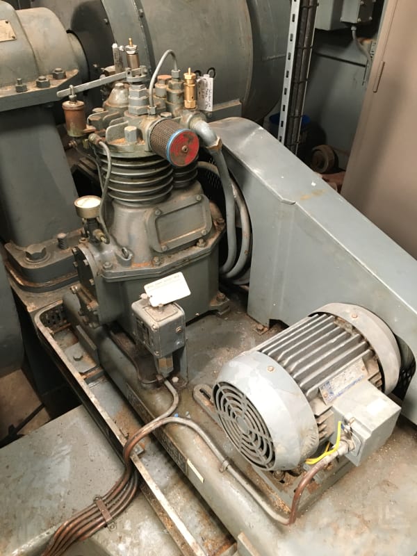

I see a belt driven small 'motor' at the side of the main exciter? Is this actually a pilot exciter?
With this size of set, the AVR often went in the 6.6kv switchgear.
After several changes of ownership, AEI eventually became part of ... US General Electric! I think that the Rugby site has been closed and moved to Nancy in France.
WH Allen were part of APE which became part of NEI (Formed from Reyrolle Parsons), then bought by Rolls Royce.
Eventually Allens were closed and the spares repairs etc went into a new company Allen Diesels: I think that this engine will be a type S12.

By the way, is the small belt driven machine an Amplidyne to amplify the output of the AVR to drive the exciter?

Hoxton123, in relation to your questions.....yes,yes and yes.
You win ten points, it is in fact a S12 engine, a VBCS12C 16 cylinder to be precise.
The engine is a complete packaged set so the thing that could be a small separate exciter is in fact the belt driven air start compressor, it also had (until it got nicked) a small diesel driven compressor bolted to the skid should it had to start in a complete black out with no air in the receiver.

I have attached some pictures of the belt driven compressor and the insulator I want to strip down to get the portion that was sat inside of the building with the insulator "sheds" that will be pointing upwards when it is installed vertical as my novelty cooling tower. Basically the cleaner portion of the wall bushing.
I love the meters in the control panel.

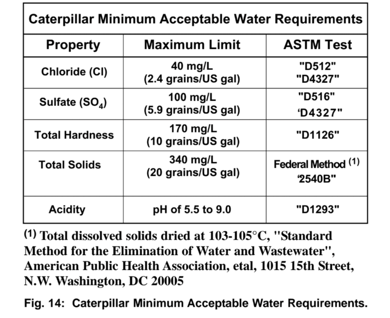

As for the water, I not only agree but any to emphasize that it is imperative that you don't put water in the engine. It's called coolant, not water. Coolant has corrosion inhibitors. If you want to go cheap, you can treat the water with any 2000 series diesel engine supplemental coolant additive at 16;1 for straight water and 32:1 for 50/50.
Sorry, the mirrlees etc sets were solidly coupled, not flexibly. Generally the larger generators had a forged shaft with integral drive flange.
You are correct about the terminology, it is correct to refer to the fluid as coolant, not water, my slip.
We used to buy pre-mixed coolant, because you must not use tap water, or worse river water. .
if you use glycol your heat exchangers etc must be about 30% larger, so its tempting to find a way not to use it.

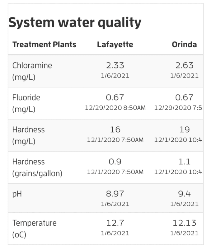

I wasn't trying to correct you. I just work in an industry that doesn't understand the importance of cooling water treatment so I always make that emphasis.
Tap water does work fine provided it meets certain requirements. We have really good tap water out here.
Required:
Delivered:
