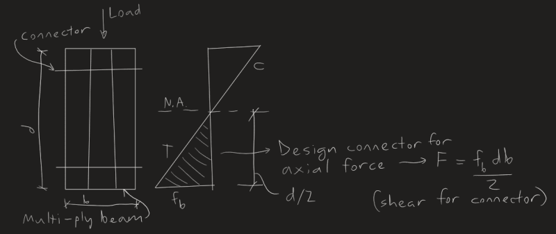

Probably a stupid question...but why does shear flow consider the shear rather than the moment? I always thought it was weird that I was taking the shear at the reaction points rather than the center of the beam, which is the max moment but zero shear. I'd think that the zero shear point needs composite action the most.
I've often been confused by this as well. I believe the shear flow is a result of the change in moment over the length of the beam (which is what shear is). If you grab a stack of printer paper and let the full stack bend between supports at the ends, the shear flow is greatest where the pieces slide against one another the most. At the middle, this should be minimal (technically zero) and at the ends, the greatest. Now if you were to glue the individual pieces together and the glue had adequate strength to resist this shear flow, you would create a significantly stronger beam versus the 500 individual pieces.
Ah that makes sense. To get half or one third of the load to transfer, you could draw the T/C stress block at max moment and get the "axial force" in the tension or compression block, then design the bolt/nail/screw for that shear force. Kind of like with concrete Whitney stress block, but simpler.

@Eng16080 You don't misunderstand, we're on the same page in terms of what we think the situation is. I think reaction doesn't account for the tension and compression forces in the beam itself, which are in a different direction. Shear would probably be zero at the point I'm talking about.

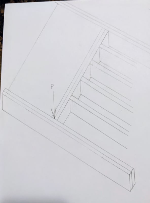

Thanks, everyone. Attached is a sketch for further clarity
wag2483, To answer your original question, I would use a double joist hanger to connect each end of the double header to the double trimmer, rated for the load P. Then, I would design a connection to transfer the load P/2 from the inside ply to the outside ply of the trimmer. This connection between plies might even be accomplished by the joist hanger connection assuming the nails/screws are long enough to get into the outer ply. If necessary, the connections mentioned above by milkshakelake and XR250 should provide more than enough extra capacity.
milkshakelake, I don't think it should be necessary to transfer the axial force shown in your cool sketch. Are you saying that's the force acting on the connection due to the beam elongating due to tension (or shortening due to compression)? If so, I think the change in length would be very small/insignificant. Also, if you created a connection with horizontally slotted holes (which can't resist that axial force), the connection would still work.
@Eng16080 I think I understand what you're saying. You transfer the shear through the connectors, which would load all the members in flexure. Makes sense.
