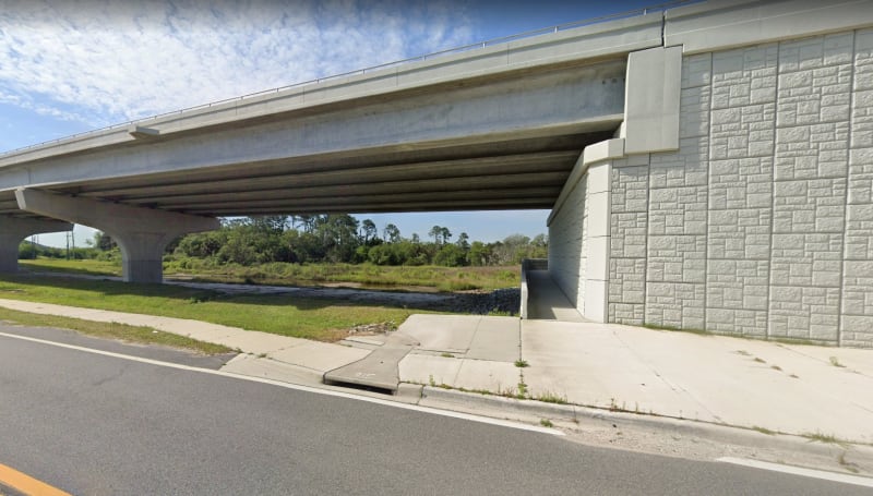

JACKSONVILLE, Fla. – A Jacksonville family wants lights to be added to the new Sisters Creek Bridge after their loved one was killed in a bicycle accident.
Brandy Harris said Chad Herrington, her 18-year-old brother, was riding his bike on Heckscher Drive the night after Thanksgiving when he didn’t see the sidewalk ending and hit the wall near the end of the bridge.
“What he didn’t know was at the end of the sidewalk, there’s two 90 degree turns that goes down to a creek side,” Harris said. ‘And he hit that wall at 15 miles per hour and him and his bike went over and he hit his head on the sign.”
The victim was not found until a week later.

I don't see any engineering failure here.

While the design can perhaps be criticised due to lack of signage and the like, it doesn't excuse the bicyclist from riding beyond the limits of his (nonexistent) lighting.
Also ... In my part of the world, bicyclists are supposed to be on the road or in a designated bicycle lane ... not on the sidewalk, which is strictly reserved for pedestrians unless signed otherwise.
I see a breakdown lane that would serve as a perfectly good bicycle lane.
Bicyclist would have been travelling in the wrong direction, too. Supposed to be same direction as traffic.
Not an engineering failure.
They could have at least put-up some reflective warning 'tape' or something. from the photos it would appear that the wall could easily be missed particularly at night, even if the rider had a headlight.

Still a failure in design... should have mitigated it, and for bikes, because you are off the ground, maybe higher guardrails...

Maybe this doesn't ride to "engineering failure" but in the absence of a law or ordinance prohibiting riding on the walkway, I'd at least call it bad design.

Definitely an engineering failure. Acres of concrete in a concrete desert needs some warnings for alerting people to changes in the pathway. That's electric wheel chair people, runners, skate boarders, hover boarders, e-boarders, bike riders, e-bike riders, whatever. Could be just some stripes on the wall or some lighting, but something.

Hmmm ... a 1-metre breakdown lane on a highway with no lighting, no warning signage, and no bicycle lane markings, or a cycleway / footpath behind a concrete barrier? I know which side of the barrier I would choose if I was riding a bicycle along that road!
That would be the case if they were riding on the roadway, but in most parts of the world, pedestrians and bicycles etc aren't restricted to only use the pathway on the same side of the road as the vehicular traffic. (Is Florida different in this regard?) Follow signage and line marking (if any), and keep right (keep left in some countries) when passing on a 2-way path, are the normal rules.
Yes, the cyclist should have carried lights and worn a helmet. (It's not clear whether he was, but a bike helmet may not have been much use in this situation.) However, designers / builders of public infrastructure have a duty of care to be aware or obvious hazards and provide mitigation - signage, lighting, barriers, etc. (There aren't many main roads that I can think of that have hard hairpin bends without warning signs, reflectors, barriers, etc - especially any built recently.)

The location is at [URL unfurl="true" said:
https://www.google.com/maps/@30.3973536,-81.46454,...[/URL]]
So if you follow the roads around to the bottom of the ramp you end up here:
There is no signage of any kind, and no lighting - no direction indicators, nothing indicating whether the ramp is mixed use (pedestrians and bicycles) or pedestrians only. (There isn't even a sign indicating that there IS a ramp - if approaching from the lower pathway, you might miss it altogether.)
The little stub wings on the elevated roadway look like they are intended to be to mount future light poles - but it's a pretty poor installation in its current condition. (To be fair - there's no lighting, and not much signage on the road intersection either.)
