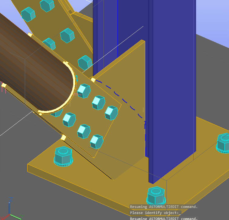

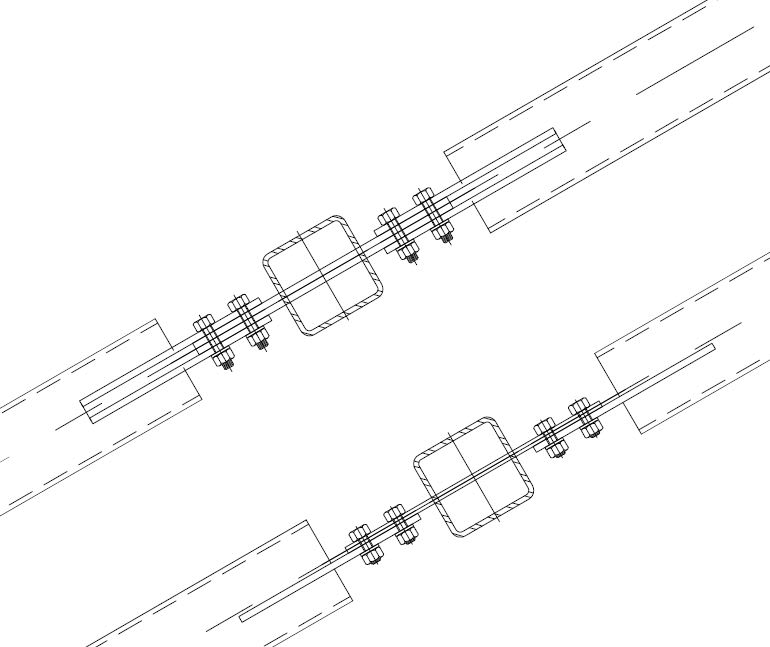

For very large loads my alternative is sandwich plate either on the strut or as 2 loose additional plates. This avoids eccentricity, avoid extra welding plus you get bonus double shear in your bolts.
That does sound marvelous. Does that make for a fillet weld access problem for one of the plates and necessitate CJP?
The sandwich plates are best loose, fully bolted. I don't like just making the single plates thicker to solve an eccentricity issue, as that increases eccentricity, so you are chasing your tail.
For me, it is bolted sandwich plates or stiffeners.
Ah... it's two plates sandwiching both the gusset and the slotted plate. I though it was a double gusset. Thanks.

The sandwich plates are welded to the HSS bracing members...Something like... The through plate in the HSS would likely be twice the thickness of the 'sandwich plates'. Fixed...

No, the twin plates if used are on the hollow section as drawn but dik normally with a spacer plate in-between, that is how I've done it in the past. Though what I was actually meaning in my above comment was a single plate on each with 2 loose plates sandwiching them I think this was hokkie's prefernce. I have no distinct preference with either option. They are both more fiddly than just using single thick plates but they are both structurally more elegant.
Example grabbed from online:
