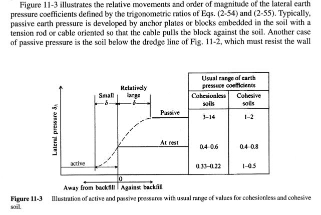

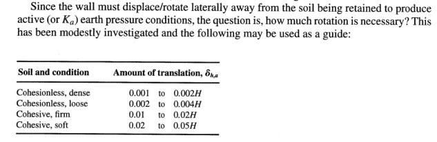

Guide for estimated translation for active soil pressure from Bowles:
If I can't rationalize full active pressure I've used a pressure between at-rest and active for a wall design that had some tight design restrictions, the eng. judgement behind this is the recognition that the pressure reduces down from at-rest to active as the wall deflects, I have done a straight-line interaction from this figure, Bowles again, and the movement values above:

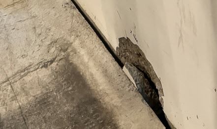

Has anyone actually ever seen a slab slide in the wild?
