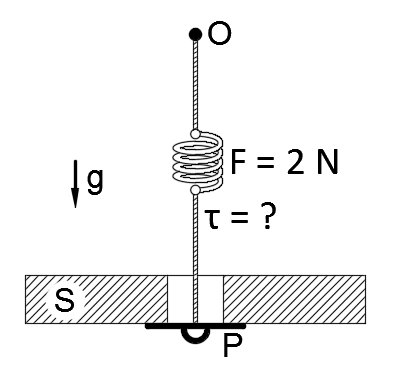

I had a job interview
and they asked me to solve a problem that I didn't understand
someone can explain it to me:
A thread F,
  inextensible and of negligible mass,
it is stretched vertically between the fixed point O and the plate P, non-deformable, and also of negligible mass.
The plate rests on the fixed support S,
  held in place by the initial wire tension of 2 N.
If the wire can withstand a maximum of 100 N,
will it support an additional weight of 10 kg applied to the plate?

For those who answered "no" and had doubts, look at the image below.
The tension in the thread is given by the elongated spring from its resting position just enough to generate the 2 N.
Now, think of attaching a mass of 0.1 kg to the target.
- Has anything moved?
- Does the spring exert the same force?
- Has the tension in the wire changed?
Comparing these findings with the assumptions used to answer "no", he will probably understand the error.
there was no spring in the first one
now it's there

But now there is an "elongated spring".
In the OP there was "A thread F, inextensible and of negligible mass."
It's one or the other, not both.
what the answer seems to be if the answer was yes is that the thread F moves away from the support F and hence the 10kg mass takes the 2N force into it's own force.
But that's in contradiction to the original question.
"inextensible" means an analytical simplification, so you don't need to worry about the extension of the spring, which complicates matters. With an inextensible thread, the plate is either a propped cantilever or a simply support beam. With an extensible thread you've added deformation of the thread into the problem, like a beam with elastic supports.
