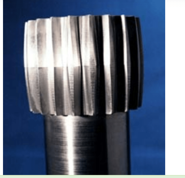

I am starting to feel that the spline sample has no lead crowning, when I look it under 20X optical comparator, it appears to be an almost perfect straight line from the top, if it has lead crowning, it should be curved, with 0.003 crowning I should definitely be able to see it with 20X vision. For some reason the inspection vendor reported lead crowning, I am guessing the operator might have it confused with the top land crowning, which is visible with naked eyes, the radius of the topland crowning is about 0.77 inch. The face width is 0.25.
the lead has to be inspected and verified with a lead, or cnc gear checker, it can not be viewed visually.
I thought if it has lead crowning, it would look like this example (random sample found online):
The CNC gear checker reported averages of 0.003 for Cβ, so I guess even with 0.003 lead crowning, I would still not be able to see the curvature under optical comparator? I am really lost
not all splines require a .003 crown , like said before it depends on the amount of mis alignment. it can vary, as small as .0003 to .005 it depends on the requirements.
on the spline displayed you can see it but you can not tell what the crown height is. and it appears that crown has severe thinning at the ends is I bet it's more than .005 crown.
which make it possible to have severe reduced loads.
For now, I am just trying to match the inspected sample.
Are you saying that even with 0.003 lead crowning, it's still normal to not be able to see the curvature under optical comparator?
Okay, it makes perfect sense using CAD, the topland crowning makes it look concaved which is opposite to the effect of lead crowning when looking straight on the topland, thats why the topland looks straight even under 50X. I knew I was missing something simple
