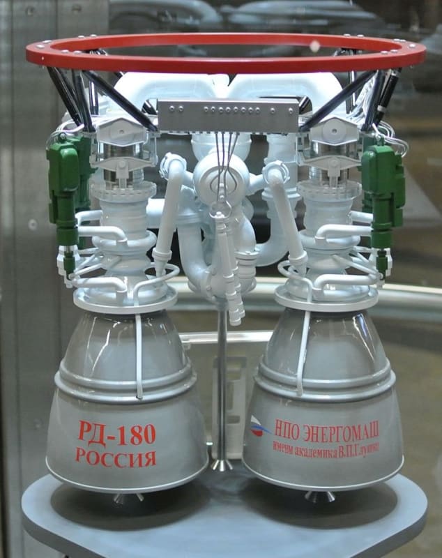

Interesting video regarding evolution/development of the simplified Raptor III [RIII] engines... for the Starship Booster. SpaceX and the Rocket engine team are rightfully proud of this simplified 'mighty-mite' engine.
However, as I was watching the video, my wandering mind said"heyyyyy, stop-the-presses... that RIII engine looks vaguely familiar!" Hmmmm...
So Inquired about the Russian RD180 engines [] and this image of these workhorses, popped-up... which appear at first/side/upside-down/glancing view to be strikingly similar to the RIII... or vice-versa... including relative length and size and performance. Hmmm only significant differences appear to the propellant... RP1/LOX for the RD-180 and L-Methane/LOX for the RIII... which really isn't that giant of a difference... and hey... the Methane fuel burns cleaner and won't coke parts like RP1 for a return to launch site deceleration-to-landing.
... but here is the SpaceX RIII 'rebuff' of the aging RD-180...
Hmmm I keep wondering if SpaceX had a peek at the RD-180... before evolving the RIII.

Wil, I had the same thought awhile back but saw that video. But still, the RD180 has been used by the Atlas V, and a lot of Russian engineers came over here after the wall fell - and I would assume quite a few (along with a bunch of US ex-Rocketdyne and Pratt engineers) went over to Musk's shop. There's been a lot of technology transfer as a result. Some of the superalloys used by the RD-180 especially help for oxidizer-rich preburner and turbines.
