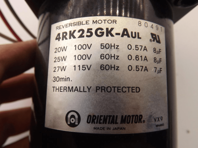

Hello Everyone!
I have a single-phase reversible induction motor with the following specifications:
Model : 4RK25GK-AUL
Rated Power: 20W
Rated Voltage: 100V
Rated Current: 0.57A
uF : 8
I am looking for a way to control its speed. Can I use a dimmer switch or a fan-speed control switch to do this? Or is there a better alternative?
Any help is appreciated!
Nope. No can do. That is a fixed speed motor.
You either need to use a 3 phase motor and a VFD
or
A DC motor with a speed controller
or
A brushless motor with a matching drive unit.

I have not done this and i have never heard of this being done, but theoretically, this type of single phase motor actually has the best chance of all types of single phase motor to operate from a three phase VFD.
From the specs I infer that this is a type of motor which has two identical windings that are connected in open delta. The capacitor develops the needed phase shift.
But, that said, there are caveats:
The capacitor would be removed before running from a three phase VFD.
The phase displacement between the windings is fixed by the physical location of the windings in the stator.
For a three phase motor the displacement is 120 electrical degrees.
For a single phase motor the displacement is 90 electrical degrees.
In this type of motor the angular displacement is unknown.
It is possible that the designer chose an angle of 60 degrees (the compliment of 120 degrees), however we don't know.

sham96; Maybe your motor is a permanent split capacitor motor.. I could be wrong, it might be a candidate. I'd still try to solve the speed issue another way. Do you really need variable speed or only a different speed?
Keith Cress
kcress -
Hey Keith.
You missed one type, but I don't know the exact name.
It is a three wire motor with one common lead and a permanent capacitor between the other two leads.
It has two identical, but physically displaced windings.
Call the leads C for common and F and R.
Power to C and F and the motor runs forward, the capacitor phase shifts the R winding.
Power to C and R and the motor runs backwards, the capacitor phase shifts the F winding.
These are commonly quite small motors working with a reduction gear and end limit switches to operate dampers.
Control is among the simplest of any reversing scheme.
Thee three wires, the gear box and the 30 minute rating are all consistent with this type of motor.
It would probably run well on a single phase VFD.

small update : I contacted the Oriental Motor USA technical division and they informed me that I cannot control the speed of this particular model. There are however other speed-control models available.

@waross Sir I can confirm your description of this motor. As you stated this is a reversible motor and the direction of rotation can be changed with a single switch(Attached the wiring diagram below)
