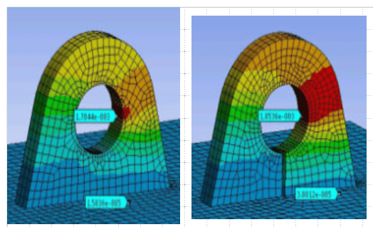

For mostly curiosity, but at this stage also the preservation of sanity, there is an ongoing discussion in our office on why we see weld on pad eyes/lifting lugs with splits in them. See image below:
We can speculate some minor decrease in certain stresses (e.g. contact stress reduction as it will more easily flex to conform to slightly lower radius of the pin inside it), but at the cost of large stress increases in other areas (bending stress in the eye, peak fatigue stress concentration for any longitudinal stresses in the plate to which it is welded to). It doesn't seem easier to weld (if anything it seems more difficult), and it doesn't seem cheaper to manufacture.
So we are generally at a loss.
My best guess is someone drew this 40 years ago by hand, sneezed near the end of the drawing process, left a line on the drawing, and went "Well, not drawing that again. Guess it's a feature now." and it never got corrected.
But realistically it's across multiple client sites, vendors, and industries. It's not common, but it exists everywhere. So there must be some reason this exists.
Can anyone try to illuminate me a little on this one?
Impressive. Suggest to eliminate the left model, then fill the gap in the right hand model with elements to replace it. By doing so, you have two models with identical pattern for comparison. Also, can you display tension, compression and shear stress with +/- scale. Thanks.
Nereth1: Great work, wish I could give you a handful of stars... what FEM program did you use?

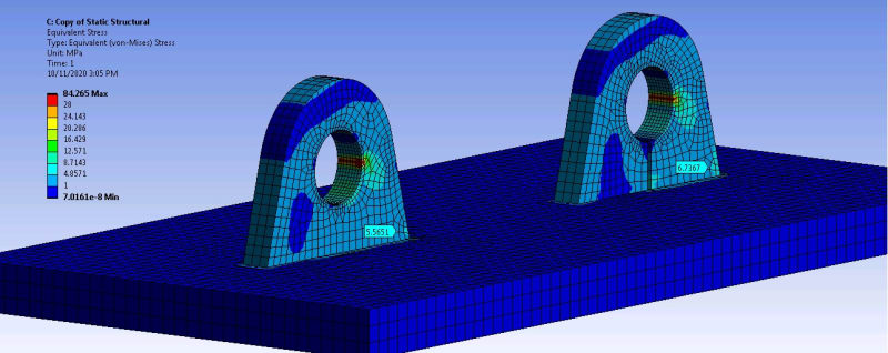

Dear Nereth1 (Mechanical), nice work... will you pls look for the pins 20 mm, and loading horizontal? ..I remember the split lugs for horizontal ( lugs loaded at 90° from verticaI ) for permanent installation . In order to compare impact loading effects will you pls look to the deflections ( at contact point )?
A pink star to you for this great work...
I'd be a little concerned if the two models were radically different...
R13:
They are identical models already. I mirrored them across the centre plane then deleted out the strip under the hole. The plates are also restrained between lugs so that stresses cannot transfer between lugs.

Pins 20mm, pulled horizontally. Tightened up mesh at contact point as results were getting discontinuous. Equivalent stress and deflection pictured below. I haven't put probes on the contact points because they're very sharp peaks, difficult to find equivalent points across the two. But looking at the ranges of stresses, they're very similar. The stresses at the base, however, are much higher on the split lug, likely because the stresses are introduced on the RHS, and have no stiff path towards the LHS for the LHS to do any real work to assist the RHS.
On deformation, there is a slight increase, on the order of 10%, however, the absolute value of the difference between the two designs, is around a tenth of a micron (at 1000N). These lugs, looking at the FEA, could probably take 10-50x the force, but assuming everything stays elastic, that's still just a few microns of deformation gained. This would almost certainly be negligible compared to whatever flex is in the chain, lifting kit, or the attached part. Any appreciable difference in energy absorption would have to happen in the plastic deformation range (and I'm running out of time today to run that analysis).

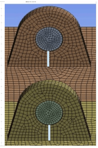

Do not mean to be picky, but the mesh on the right is finer then the left. The differences are small, are exist.

You're right ofcourse, but the chance that it changes the results enough to change the conclusion, is minimal, given how many (quadratic) elements are already there. Purely based off my judgement (not really worth a convergance analysis)
