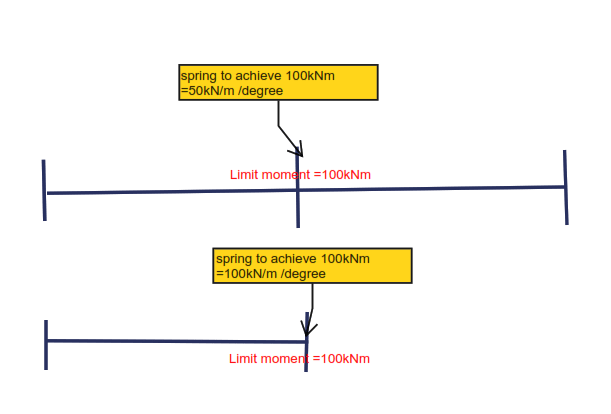

Here's the simple sketch for your understanding. Imagine that the interior support can take up to 300kNm, while for single span fixed fixed condition, it can take only 150kNm, my interest is to limit all the hogging moment to lower value (say 100kNm), so i adjusted the spring value. I found that the amount of spring value that required to achieve certain amount of reaction moment at support for continuous beam is lower.... Why ?
I don’t understand your question sorry. What do you mean by “can take up to 300kNm”, etc.
And if this is a symmetric continuous beam there shouldn’t be any rotation at centre support, so why is spring of support relevant?

It's just practice, the value doesn't matter, I just want to get clear concept about the relationship of spring, continuous /discontinuous beam.... I am aware there's too much distribution.... Just forget abut the code. I just want to know why when the beam is continuous, the spring value required to achieve certain lower value of reaction moment is lower....
The node rotational spring stiffness is lower for the continuous beam because the second span also has a stiffness that contributes.
Single span node stiffness = continuous beam node stiffness + stiffness of second span.

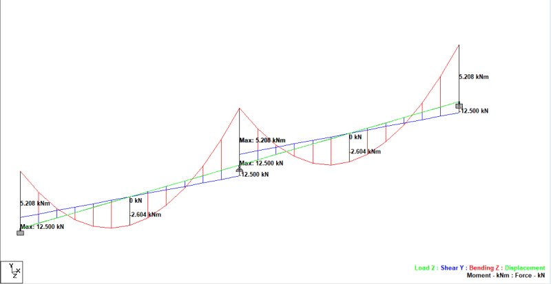

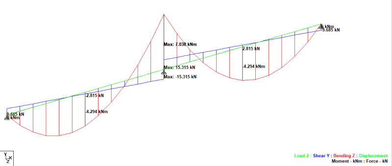

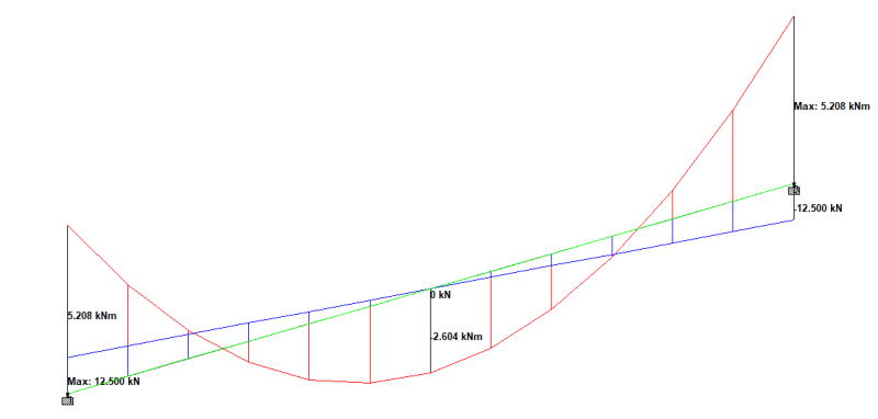

My actual model is more complicated than the exampel posted below. To simpligy things, I have model 3 beams below, one with single span beam subjected to UDL , another two are continuous beam subjected to UDL ..
I was trying to model this situation out ( with all 3 fixed condition) , but it seems that I cant do it in Staadpro . I have no idea why I am not able to model fixed fixed fixed beam ..
However, I tried to model in 3 situation
a.)fixed fixed
b.) pinned pinned pinned
c.) fixed pinned fixed
Surpisingly, fixed fixed pinned acting like fixed fixed , with no chnages in reaction and moment ...
I wonder why the loading is different ?
The first (single span beam) has 25kN applied, the 2nd and the 3rd seem to have 50kN applied ?
The 2nd doesn't look like "pinned pinned pinned", the 3rd doesn't look like "fixed pinned fixed" ... that'd imply zero moment at the mid support ?
2nd and 3rd show the difference between pinned and fixed supports with a continuous beam.
To get 2 SS spans you need two nodes at the mid support.
