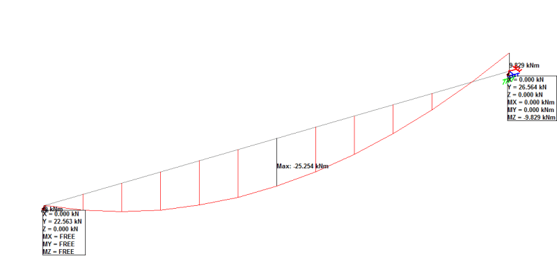

We all know that the continuous beam is generally stiffer, hence , the interior support can attract a fair value of hogging moment.
I am playing around with the spring rotation value to limit the hogging moment reaction to certain amount (lower value compared to all fixed condition). However, I found that when the beam is in continuous , the amount of spring value that required to achieve certain amount of reaction moment at support is lower. Is it wrong ? Why ?
Can someone help to explain it ? Say that when in all fixed condition, the reaction moment at interior support is 300kNm, but I want to limit it to 100kNm only. Hence, I adjust the spring value to achieve it. In single span fixed fixed condition, the spring value is 100kNm /deg , but in continuous fixed-fixed-fixed condition, the spring value is 50kNm /deg. Why ?

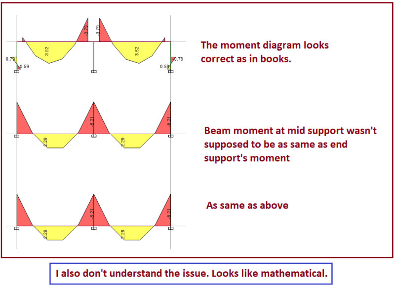

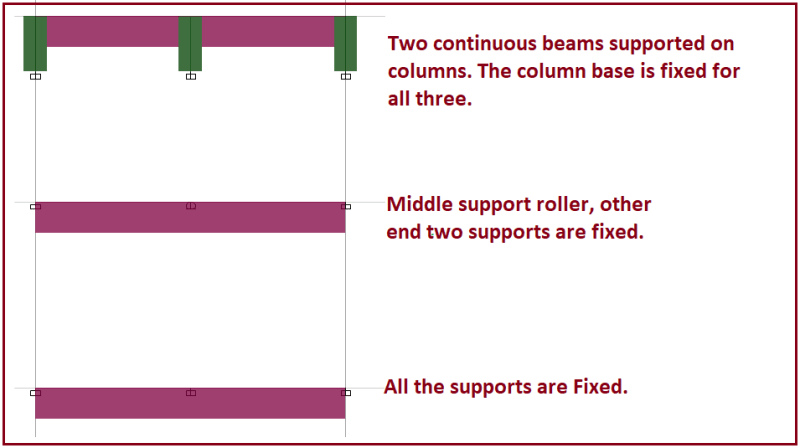

Suprsingly, 3rd one looks like 2 SS beam albeit I have assigned the support to be fixed pinned fixed for the continuous beam.
" I have no idea why I am not able to model fixed fixed fixed beam ." because that over constrains the model, you need to review both Moment distribution and then stiffness methods.
"The 2nd doesn't look like "pinned pinned pinned", the 3rd doesn't look like "fixed pinned fixed" ... that'd imply zero moment at the mid support ?"
No, a continuous pinned beam will have negative moment over the interior support the diagrams are correct.
"Surpisingly, fixed fixed pinned acting like fixed fixed , with no chnages in reaction and moment ..."
this is the correct behavior for a two-span continuous beam the fixed ends and a constant uniform load.
"huh ? The beam is each 2.5m each span , subjected to UDL of 10kN/m" ok ... I thought you were looking at the same span, and the impact of a central support.
ok, so re-run the 1st pic as pinned-pinned (it looks fixed-fixed)
"Surprisingly, 3rd one looks like 2 SS beam albeit I have assigned the support to be fixed pinned fixed for the continuous beam."
ah, not when I went to school ... 3rd pic has moments at the ends, therefore not pinned.

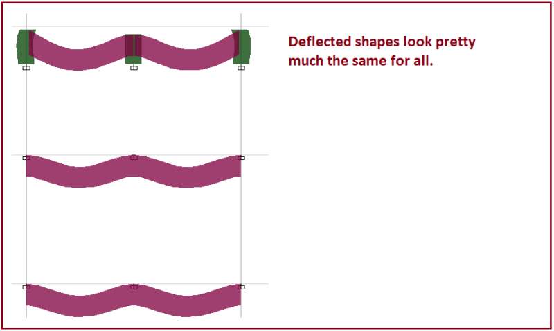

the 2nd pic looks like pinned-"fixed"-pinned ... is the slope at the mid support zero ? then it is pinned-fixed-pinned. if it is non-zero then it is a continuous beam with pinned supports.
the 3rd pic looks like a continuous beam with fixed ends. (or if the slope is zero at the mid-support then it is fixed-fixed-fixed).
The structure is symmetric with symmetric loading. There is no rotation of the centre node due to symmetry: it can't rotate clockwise or anticlockwise because either would be asymmetric, so rotation is zero.
So, the results with pinned central support are the same as for fixed, because there is no rotation even in the pinned case. A fixed support at the centre changes nothing. Likewise, a rotation spring changes nothing because the spring stiffness is multiplied by zero rotation.

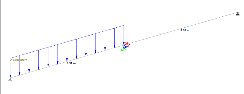

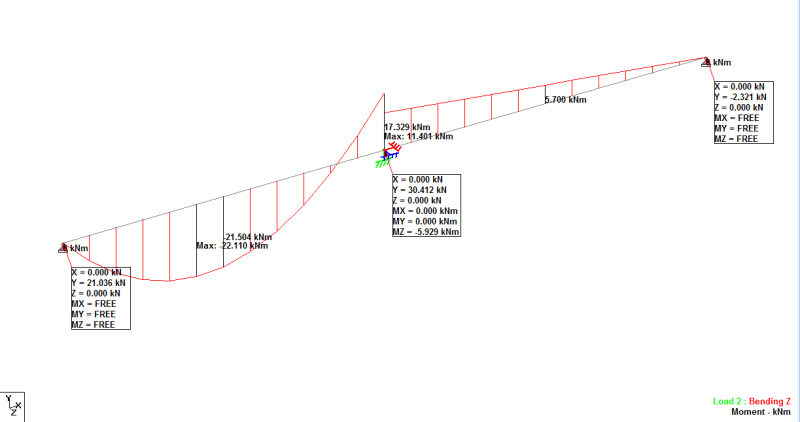

I have rebuilt a new model . It’s a 2 span beam with udl on left side only. I assigned spring support to the internal support with spring rotation = 10000kNm/degree. Here’s what I found. The reaction moment is continuous beam is somewhat lower in continuous beam compared to one span beam… I have also found that the beam moment at support for higher for continuous beam.
1.) Can I say that continuous situation making the joint stiffer, so when I applied same amount of spring at the same support in SS beam and continuous beam, the continuous beam can take higher moment? (Hogging moment at suppoort in continuous beam (17kNm) is higher than hogging moment at one span beam (9.8kNm).
2.) I also found that there’s some moment at the right end, even it’s not loaded .. Is it due to the stiffness of second beam ? The stiffness of second beam attract some value of moment to it ?
3.) Due to the attraction of moment to the second beam, this help to reduce the reaction moment at joint effectively ??
Yes of course. The second span is another spring, which helps resist the load in the first span.
Again, this is what you would expect. It *IS* loaded, via the first span.
Yes. The second span is another spring, which reduces the load in the first span and in the spring you added at the support.

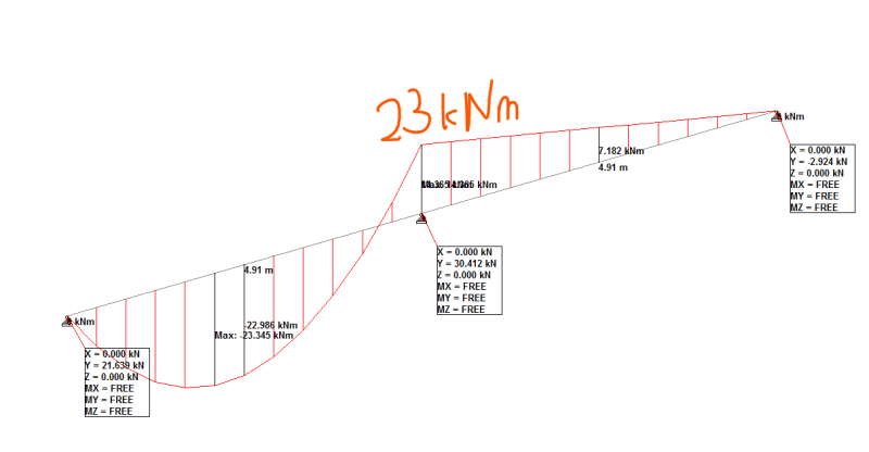

I have modelled a continuous beam with continuous support , interior support is pinned, surprisingly, the moment formed at the support is higher compared to the moment when I assigned spring moment at the interior support,
how can this happen ? I thought when there's extra support , then joint will be much stiffer , hence more moment can be formed at the junction ?
When the interior support is pinned, the moment at the junction where the beam is loaded is 17kNm, when the interios support is pinned only, the moment at the junction is somehwat higher (23kNm) , what's worng with it ?
Check the moment in the second case. You've written 23 kNm but all other signs point to it being 14.4 kNm.
Where does it show 14.4kNm ?
I calculated that from the other results that are visible. Eg you can simply double the 7.182 kNm at midspan since the right span moment is linear.
Thanks I will check out again, the 23kNm i gt it from different analysis software, the diagram was from another analysis software. I have left the model elsewhere , due to time constraint, I rebuilt the model using another sofware , and sketch the value on the diagram....
I will check the value in the old model again. I am not sure what's wrong in the new model on the different analysis software.
The text isn't legible, but since the moment at mid-span of the right-hand span is 7.18 kNm, and the distribution is linear, 14.4 kNm looks like a pretty good estimate to me.
