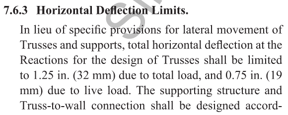

I believe the TPI for lateral deflection is 3/4" and you can't realistically do much with the truss to reduce that horizontal deflection. It's the nature of the structural system that it spreads. Same as rafters with an elevated tension tie (NOT a collar tie! Collar ties are in the top third of a roof, tension ties or elevated ceiling joists are in the bottom third).

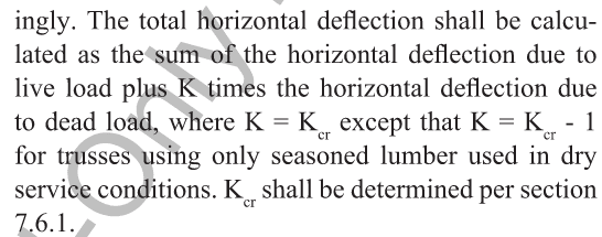

Someone mentioned the TPI limit - It's actually 1.25".

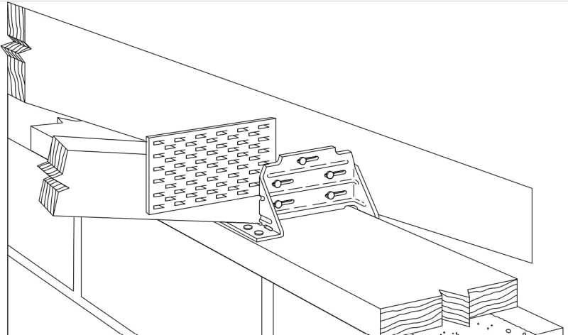

I'm a fan of the Simpson scissor truss clips that Lexpatrie posted a picture of. I believe the theory is that you set the trusses, but leave the nails loose in the slots. Put the roof on, so most of the deal load is on the trusses. Then re-plumb the walls and drive the nails tight.
After that you'll still have live load deflection to deal with. But the dead load has mostly been taken care of.
I think expecting the contractor to leave the nails loose and then to go back and drive the nails is a fools errand. That is why I never specify these.

In OPs case, that clip doesn’t make much sense considering that the truss is being relied on to resist wind forces pushing into the wall.
If the wall was not relying on the roof for lateral support, perhaps then it might be of some use, but I find it unlikely that this detail gets constructed correctly. Even if the builder installs the clips correctly without the nails fully hammered down and positioned correctly within the track, the interior and exterior finishes would need to be constructed in a manner which allows the horizontal movement. Besides that, there will be some friction force between the truss and wall top plate which might also prevent the detail from working as intended.
I'm going to say that the Simpson TC24 the nails aren't driven flush. At any point. They'll perhaps squeak. I believe they are tested in the "loose" condition. I believe it's rated for uplift and load perpendicular, so as a mild diaphragm force transfer.
Interesting point about the wind on the wall, though. Ron can you give us an excerpt of the 1.25" horizontal spread from the TPI?

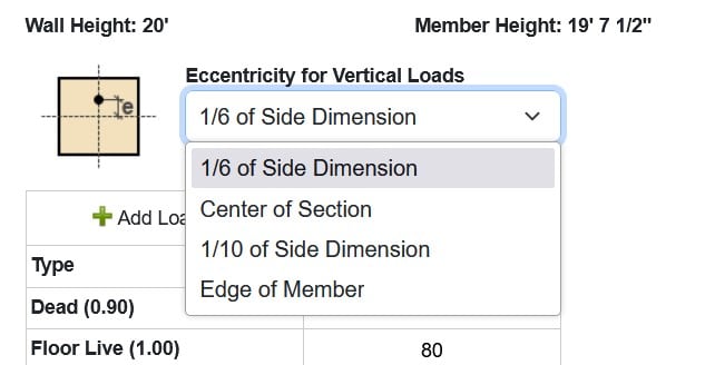

FWIW, I think it is a common practice for wood stud walls to be designed including a D/6 bearing eccentricity. It might make sense to bump that up accordingly when you have a roof system with significant lateral spread under load.
Lexpatrie said: "Ron can you give us an excerpt of the 1.25" horizontal spread from the TPI?"
No idea what you're looking for.
That D/6 is done by some folks, I wouldn't call it standard practice or code, it's an optional check box in Forte as I recall. I may be out of date, though.
It think quite a bit of the Weyerhaeuser load tables include that effect, however. It makes more sense to me as something for isolated deck posts.

I have only been practicing with wood design for 3-4 years now, so I'm not an expert by any means. But I have seen that D/6 eccentricity considered pretty often in wall stud designs. It is a default setting in Woodworks Sizer.
Regarding live load in the deflection provision, the TPI 1 document defines live, rain and snow under the umbrella label of live load.
I think it's possibly coming, in terms of code, but when it comes to a wall stud, there's ... anyway. There's so many of them when it's wall studs, that seems unduly punitive.
It makes more sense to me on posts.
Sizer is Canadian in origin, so it's perhaps part of the Canadian code. I wouldn't know.

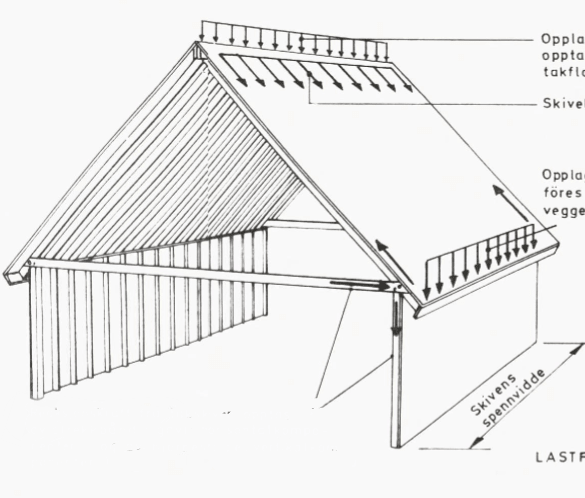

Don't do much wooden structures, but could you, in theory, utilize the roof as a semirigid slab to transfer this horizontal force to the gable walls and limit the deflection?

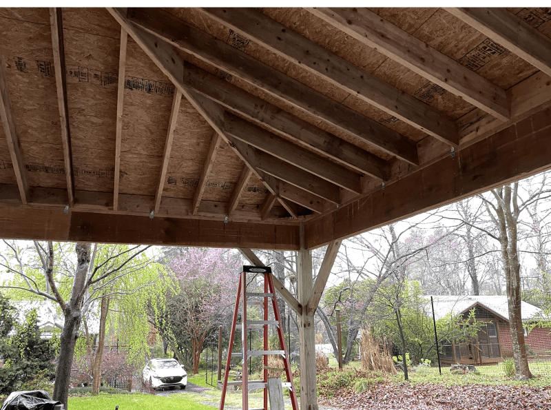

Here is one I looked at yesterday. Been there 12 years with no signs of any distress. The beams are perfectly straight. It is about 22 ft x 22 ft. So, yea, the roof does act as a semi-rigid slab.
There's something going on at least potentially, though a gable and a hip roof aren't all that comparable. I've thought about it, since I had a building official flag something like this in the real world, but there's no obvious "out" for the end reaction v = wL/2 to hold it up. I suppose the rafter to top plate connection is doing it, one rafter at a time, .... the one I have very deeply does not work in traditional static load paths and has stood for 100 years. There's construction that hasn't fallen down yet and what we can prove via structural analysis and the two don't 100% overlap. That idea of using the sheathing as a sort of deep plywood beam comes up a lot, particularly from "outside" the structural engineering community.
Actually, I have two projects like this, both 100 years old or more. (i.e. they are wood planks, not plywood/OSB and not blocked)
The sheathing-as-a-deep-plywood-beam exists.
The problem is, we engineers don't typically have the tools, or the time, to include this effect in our calculations - we like discreet load paths and this ain't one of them.
Fair point JAE, even detailing a couple of simple wood shear walls could blows our budget, a tall roof beam would in principle be more of the same.
