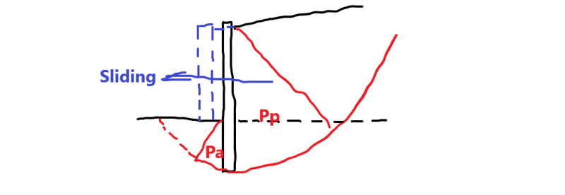

I am designing a soldier pile wall for the first time with the following:
Retained height - 11.2'
Ka=0.46, Kp=1.6 (after using reduction factor from AASHTO), pile spacing=8', concrete dia.=3', phi=30 degrees, unit weight-120 pcf from backfill to excavated height, and then reduces to 80 pcf, LL surcharge=250 psf on both faces.
Based on this, I am getting a depth of embedment of 21'.
I had 2 questions in regards to this. 1) Does the depth of embedment look right?
2) How do I calculate the stability of this wall? I cant find the procedure for this.

Thank you for letting me know about the overturning and sliding checks. How do I check for the rotational stability?
I am trying to stay away from hard rock, hence the use of 3' diameter shafts. If I go down to 2.5' which is the minimum that I need, the contractor would have to drill into rock. Right now, the bottom of pile embedment is at least 1' above the top of rock elevation.

So in essence, when I designed the depth of embedment by summing the moments about the pile tip as zero, this was simultaneously being checked for overturning, is that correct?
I understand the point about not checking for sliding because of the passive pressure. Do I still need to check for rotational stability?
Provides the pile embedment is greater than, or equal to, the design called for, do you think the failures in the sketch can occur?
The way I think about it, rotational stability is the only stability check/design that is applicable to a soldier pile wall. Structural capacity for the max moment and shear, of course, must also be adequate. In some instances, excessive deflection may also be a design criterion. To calculate deflection, if it matters, I suggest using P-y curve analysis software, such as Allpile or Lpile.
There is no sliding for a non-gravity wall. There may be some lateral deflection at the dredge line (always much less than at the top) to engage the passive resistance of the embedment soil in front of the wall, but it cannot fail in sliding, so attempting to apply any spec. provisions concerning sliding to this type of wall will only lead to confusion and/or incorrect conclusions.
