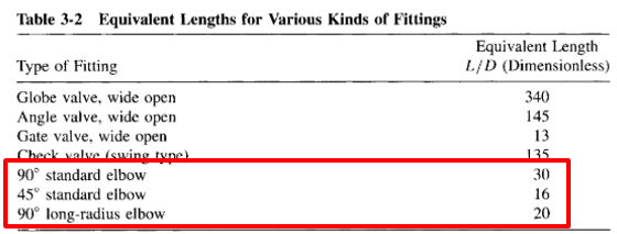

From Table 3-2 Equivalent Length =30 for 90° standard elbow.
There is no definition about standard elbow.
Does that mean equivalent length =30 for 90° standard elbow no mater it is threaded joint or flanged/butt welded joint?
It is not consistent with Crane TP-410.
From that table, I would call socket/threaded, or 1.0R short radius elbows, "standard".

I Googled the table title and Google Books shows this table on page 63 of "Transport Phenomena and Unit Operations A combined Approach" by Richard G. Griskey. Hopefully the OP will confirm/deny.
@jari001
Thanks. What is your idea about standard elbow in that table from "Transport Phenomena and Unit Operations A combined Approach"?
