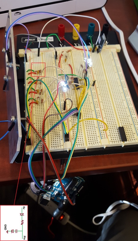

I have recreated the issue using an arduino so that is what I am not testing with.

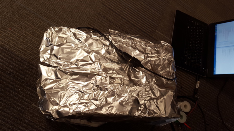

I have taken the board and the arduino and put them in a box that I covered with aluminum foil and grounded and still had the issue.

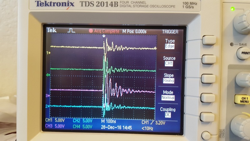

I added some weird Diode low pass filter combination to each input pin and that seems to have helped, but not fully removed the issue. I haven't fully tested weather it is the low pass filter or the diodes that are making the difference, but from the little I have tested I think the diodes have helped the most.
here is what I can still get on each input pin using the oscilloscope.

You could try opto-isolators on the input pins. That possibly would help if the noise coming into the register is from the input pins.
