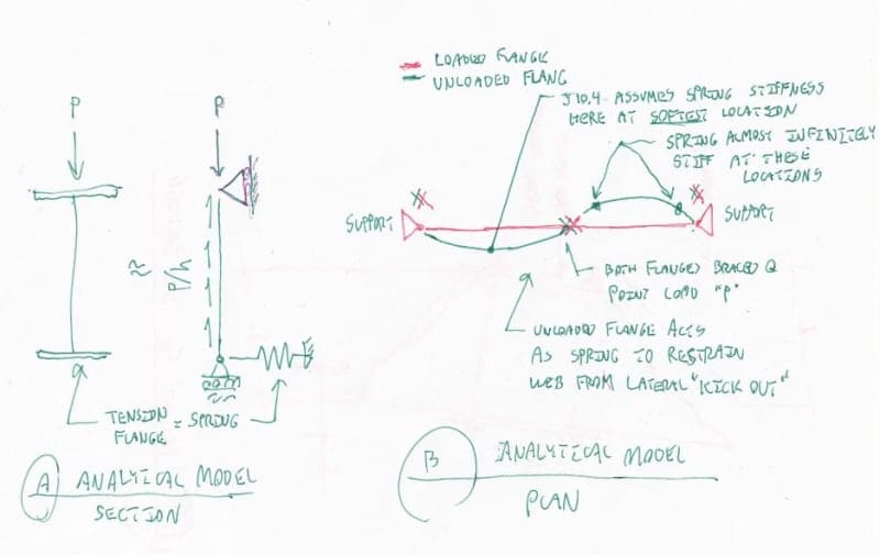

Alright, so my questions:
[ol 1]
[li]In my first snippet AISC states this limit states only applies to beams where relative lateral movement between flanges is not restrained. However, Figure C-J10.2 (or J10.3 depending on edition) defines the unbraced lengths used in the web sidesway buckling equations. The last figure shows the top and bottom flange braced at the location of the concentrated load and defines the unbraced flange length as L/2. Shouldn't the limit state not apply?[/li]
[li]AISC states for flanges "restrained against rotation", do they mean - the local compression flange is restrained against rotation or the entire section is restrained against rotation? Or do they mean that the compression flange is restrained against lateral translation? In figure CJ10.1 they show the compression flange as being braced against lateral translation. Also in the commentary they state "(such as when connected to a slab)".[/li]
[li]Would this apply to the end of a uniformly loaded beam? I want to say no, because it states the "loaded compression flange". In the case of the end of a beam, you would have a "loaded tension flange".[/li]

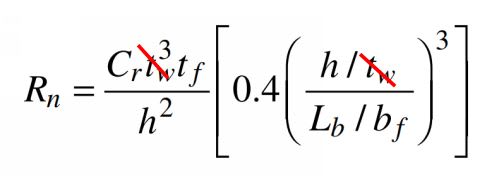

Actually it doesn't. Gotta bust out a little 8th grade algebra to drill down to the truth of it.
It drives me a little nuts the way that AISC does this sometimes. They do a bunch of unnecessary algebraic manipulation to make the equations look "consistent" and, in the process, confuse the heck out everybody with regard to the true nature of the expressions. Jury rigging things to include variables that aren't even legit parameters... Timoshenko would not be impressed.

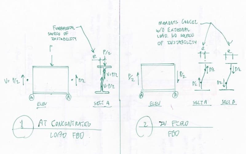

To my mind, it's just about absolutely impossible for the web to buckle (in sidesway) with a large number of stiffeners present.
Let's try this another way. A concentrated flange load will produce a rollover tendency (buckling) in a wide flange beam with imperfection. Hopefully we're in agreement there. Are you able to articulate why you think that stiffeners would aid in resisting that tendency in the absence of loaded flange rotational restraint? What is the mechanism of resistance in that scenario? I know that you don't think it's torsional capability as you've mentioned the results of your FEM studies on several occasions in reference to the biannual "do stiffeners resist torsion" threads.
I think at that point you would be engaging the whole of the beam (if it had the proper rotational restraint at the ends). And yes, a single (or even several) stiffeners are really not going to alter things as far as the beam's rotational properties go. But adding one every few inches (say the depth of the beam divided by two)? That's got to change things.

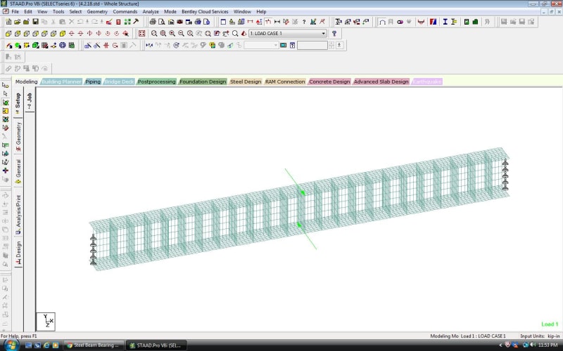

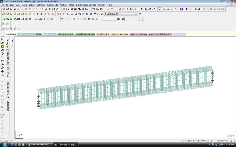

Ok, I ran a beam with and without a ton of stiffeners. (Via STAAD using all plate elements.) I modeled a W12x30 (with a 10' span) and put a 120 in-k torque at mid-span. (By putting in point loads as lateral loads applied to the flange edges.) In the first model, I had a bunch of (full depth) stiffeners: 0.5" thick, spaced 5" o.c., and fully fixed to the flange and web. No corner "clips", and it's 23 pairs of stiffeners in all. The only restraint was a "pin" support starting 2" below each flange and going along the full length of the web at each end. (About 5" away from the first stiffener on each end.) The results I give are for the center-line of the web at mid-span.
The results for the applied torque:
W12 without stiffeners: 0.223 rad rotation
W12 with stiffeners: 0.138 rad rotation
[Theoretical rotation (without stiffeners via a spreadsheet I have): 0.153 rad]

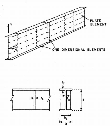

Just to make sure I wasn't getting some sort of distortional affect in the model without stiffeners.....I ran a third model with a single stiffener at the point the torque was applied. It did not significantly alter the rotation.
Extrapolating the added rotational stiffness from the added stiffeners (just comparing STAAD models) we get 74 in-k/0.085 rad. And that equals 870.58 kip-inch/rad.
How does that compare to required torsional/rotational stiffness for beams as per Appendix 6? That covers the required rotational stiffness for some light to medium loaded beams in such cases ......not quite there for a heavily loaded beam.
But this demonstrates rotational stiffness can be added by lots of stiffeners.....that would likely preclude sidesway failure (where the compression flange is not restrained against rotation)......but a number that would be impractical. (Which explains its omission from the code.)
Will continue to collate results (where time permits) and advise anything I find of interest.

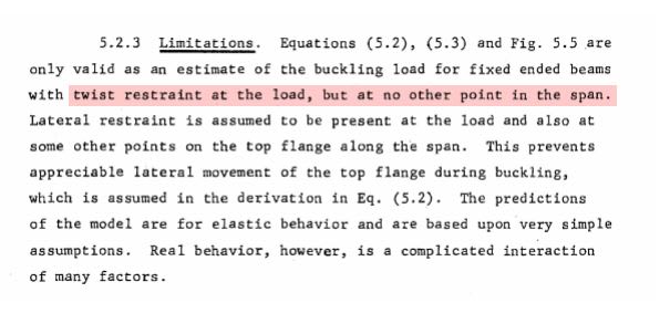

I believe this to be the Yura document that served as the basis for AISC's current web sway buckling provisions. The rabbit hole goes even deeper than I thought with considerations of web/flange junction platicity, moment gradient etc. Some sexy Plexiglas physical modelling too.... Anyhow, I note the following which I feel lend some credence to my thinking here:
1) None of the testing performed involved stiffeners other than those included at the concentrated load and at the support.
2) None of the FEM modelling performed involved any stiffeners other than those included at the concentrated load and at the support.
3) The "Limitations" section describes the results as being only applicable to beams rotationally restrained at the point of load application and only the point of load application.

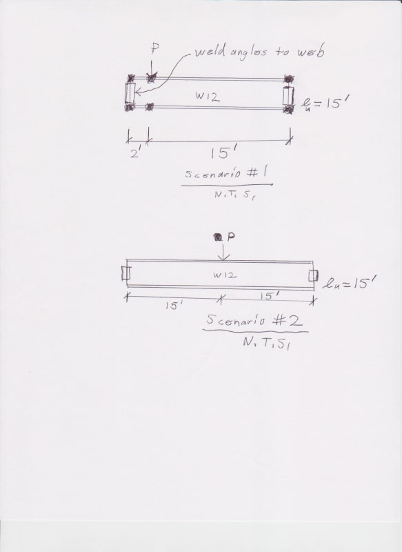

If you are able spare the time for another kick at the cat, how about:
- W18x40
- L = 24'
- 3/8" stiffeners @ 24" o/c
I would consider that arrangement to be nearer the border between practical and excessive. I'd do it myself but, alas, I don't have access to expedient software for plate FEM these days.

If you do get around to it, let's go with w16x26. I'm finding that the bulk of the work out there is Yura's and the overwhelming bulk of what he tested and analyzed was W16x26. If you investigate that beam size, we might be able to make some meaningful comparisons to existing testing etc.
What do you want in terms of length (of the beam), stiffener spacing, and stiffener size?

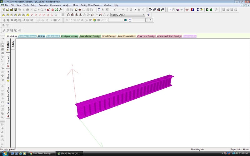

Could you post your calc and some screen shots of your FEM model? As it stands, I don't really have any convenient means of critiquing your conclusions.
The hand calculations are on scratch paper. (Not real formal.) But you can confirm some of this with the numbers I gave you. (I.e. rotational stiffness, etc.)
As far as screen shots......see below.

My theory is that the AISC checks for web sway buckling don't apply between concentrated loads and, as a result, neither additional rotational restraint nor additional stiffeners are required between concentrated loads. Does the highlighted sentence below not suggest that similar reasoning was used in the development of the provisions? It was taken from the research (Yura) that underpins our current provisions for web sway buckling.
What it suggests is what his criteria was. He also says this: "Real behavior, however, is a complication interaction of many factors."
What do you think is a reasonable span:depth for a member transferring a good sized concentrated load? Eighteen maybe so about 24'?
Now that I've seen your model screen captures, I understand this. I thought that you'd meant a continuous lateral support along the length of the beam 2" down from the loaded flange. I think that the model should have continuous lateral support but located at the loaded flange. I think that would move the needle some from being a pure torsion situation to something more like the bottom flange acting as a lateral girt which is consistent with the models used in the literature, particularly for deeper members.

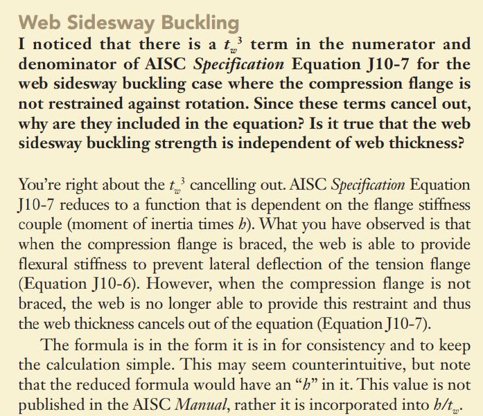

Check out the snippet below from a Steel Interchange article of old. It seems that others have been curious about the tw cancellation too. And the response seems to be in line with my thinking: webs are considered to restrain the unloaded flange by cantilevering down to the unloaded flange from a rotationally fixed top flange. Therefore, they are useless when the top flange is not rotationally restrained. We kind of glossed over the argument that I was trying to make with that in our side debate as to whether or not tw was a real parameter. The argument that I'd intended to make was this:
1) Stiffeners address side sway buckling primarily by adding stiffness and strength to the web and thereby restraining its distortion.
2) For the case where there is no loaded flange rotational restraint, the design equation does not give any account to the stiffness or strength of the beam web, suggesting that it is not a significant behavioral factor.
3) If the stiffness and strength of the beam web are irrelevant for the unrestrained case, then surely increases to the stiffness and strength of the beam web by way of intermediate stiffeners are also irrelevant.
4) If intermediate stiffeners are of no design relevance for the unrestrained case, I take that as indicative of side sway buckling not being an issue between concentrated loads.
I'm making a few logical leaps of my own here but I think that the argument has merit.
I supported it that way because I didn't want anything resembling a rotationally supported flange. The test here is: can the member (with a ridiculous number of stiffeners) essentially brace itself (for a lack of a better way to put it) with it's new rotational properties....without flange rotation support as per Section J10.4.(b).

Ok so do you still want me to run it? The criteria is:
-W16x26
-L=24'
-Stiffener thickness= 3/8"
-Stiffener spacing= 8"

To illustrate my point (looking back over my posts, I'm not sure if I have been clear enough as to my many suspicions with this provision), please consider the following scenarios (building on Figure C-J10.2):
In both cases, I consider the compression flange restrained against rotation (and lateral translation).
Ok, considering Scenario #1.....if P was (say) equal to twice the sidesway capacity of the beam (and lu at that point is 15'), you'd put in a stiffener or doubler plate (as per J.10.4.(a)).
Obviously the same deal with Scenario #2.....but wait....what about the ends? Why would you have to use a stiffener in Scenario #1 but not the ends in Scenario #2? The situation is almost [red]identical.[/red] In fact, if it was close enough, you'd wind up having a stiffener just about [red]on[/red] the clip angles. (As per the code. And the allowable sidesway makes no provision for the load's location on the beam, just the largest unbraced length.) If the load was high enough (in the middle) and the unbraced length was long enough....any stress distribution probably would bail you out either.
You could make the case for the end clip angles acting as a doubler plate (what about a knife plate connection?) or rotational stiffness provided by the connection (moot point since the largest lu controls). But hopefully this illustrates why I've always been wary of trying to address this by anything other than cutting down on unbraced length......and also why I think it is probably applicable to more situations than just bearing or point load.
I do but:
1) I'd want you to run it my way. 1D stiffeners; lateral restraint at the top; lateral flange point load at the bottom center.
2) My way may well already have been FEM'd in Yura's stuff. I've got a lot left to digest.
So I probably shouldn't ask you to waste your valuable time just yet.
I'd put a stiffener in without even checking J10.4 as I simply think that it's good practice to do so. Were I basing my decision solely on J10.4, however, I would consider myself to have choice in the matter. Were I feeling lazy, I would just follow J10.4 and add stiffeners. Were I feeling motivated to the omit the stiffeners, I would refine the calculation to reflect the fact that the bottom flange performing the bracing function is almost infinitely stiff laterally at the end of the beam. Thus the bracing stiffness is vastly higher than considered in J10.4 which assumes that the point load occurs at mid-span. See the comment above where I introduced the first sketch below.
WARose said:
Why would you have to use a stiffener in Scenario #1 but not the ends in Scenario #2? The situation is almost identical.
I disagree, the two cases are polar opposites from a stability standpoint. Put simply, scenario one has stability demand near the end where scenario two has none. You can see this easily by doing the FBD exercise that I did previously where I introduced the second sketch below.
Here's another way to think of it. Any genuine instability in the system will cause the system to shed potential energy and the applied load to move closer to mother earth. If you took scenario two and somehow induced some web buckling locally, near the end, the load at the center would not move closer to the earth appreciably. If you conducted that same experiment for scenario one, with the load at the buckled locations, the load would definitely move closer to the earth. And, at the end of the day, that's all that you really need to know. The rest is just mathematics that I'm probably no longer fit to undertake if, indeed, I ever was.

This is not correct. The code provisions assume a stability demand at the center of the beam where the unloaded flange, which does the "bracing", is at it's least stiff. Review any of the papers that we've been bandying about and you'll see the PL^3/48EI business pop up from time to time. From a stability perspective, a load anywhere else on the span is better. As I mentioned previously, multiple loads do give me pause.
But Scenario #1 demands a stiffener as per code (i.e. your interpretation of it)......but Scenario #2 doesn't. Doesn't make a bit of sense. That web is going to have just about the same compressive stresses and nearly identical boundary conditions. Doesn't add up.
It is correct. The code point-blank defines "l" as the "largest laterally unbraced length along either flange at the point of load".
Unquestionably (with the proper bracing at the concentrated load) you can wind up with as much unbraced length in Scenario #1 as 2.
I believe that they both require rotation restraint at the ends. For this, for LTB, and probably for a bunch of other issues I've failed to consider.
