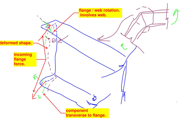

You're right. The model that I've been building in my head is shown below and the twist at the top and bottom flange offset one another, at least in the absence of consideration for second order effects etc. Thanks for the clarification.
I was kind of imagining the general, shear center offset thing with channels but that's quite independent of the kinked joint business, even if both effects would affect flange stresses concurrently.

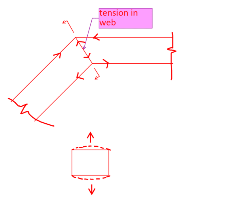

It is also necessary with high moments as kinked beams cause weak axis bending of the top and bottom flanges of the tube at the joint.
Was looking for some guidance on why there is weak axis bending of the flanges at the kinked joint - not able to picture it in my head...
EZBuilding, there is a tension or compression force in the web.
In the case of a cranked HSS, this force will bend the flanges.
