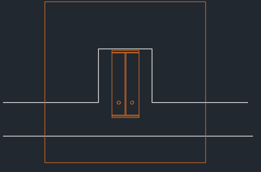

Yes, I meant to say load combinations, sorry. There is no COL at the moment, and no live/snow load, so even with very conservative 5 psf dead load over the footprint, column trust will scale down to 2.7kip which should not be a problem. Now, any ideas on how to restore a full capacity, considering space constraints below? preferably no additional structural elements to be placed in the hatched area:

I have no idea what you are talking about as far as restoring full capacity.
I also have no idea what you trying to show in your sketch. A few more dimensions might help as well as telling us where the sketch is located in the building.
Jim
I meant at this point in time (during renovation) there is no collateral load and there is no snow expected for another 3 months. So as a temporary measure during the project, existing foundation should have no problems with resisting sliding/overturning. Now it might or might not be adequate with a full snow load (DL + COL + LL) and ideally I would like to have it taken care of before heavy snow. Here is an updated sketch, the 2 columns are in a middle of the building at 75/0/0. This is the only frame which had the slab removed

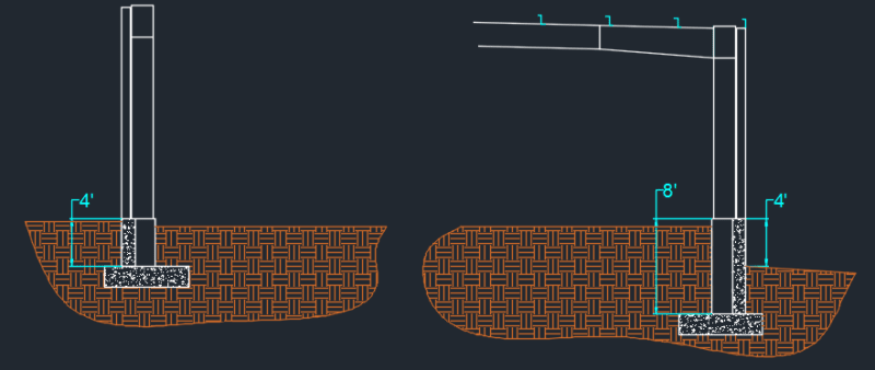

No, the existing foundation alone is fine handling the reduced load, so I want to design a reinforcements for the existing foundation, or some sort of a connection, so it can handle the full load before the building can be potentially exposed to it. Existing footings appear to be 4' x 4', and pedestals and grade wall are 4' tall on the front, and 8' tall in the back. Pedestals are 16" x 16"
Shear key.
If the foundation wall shown in your most recent sketch is correct your pier is 16" wide (parallel to foundation wall) x 24" deep (perpendicular to foundation wall). Assuming foundation wall is 8" thick.

I assume the column isn't there at this time. So, a pocket can be created in the existing pedestal to receive a shear key to restore lost shear capacity.
Foundation wall is 10" or 12" thick depending on location. So using this approach, piers are 16" x 26" and 16" x 28". Of course we have no idea how the reinforcement was placed, but judging by anchor bolt location, stirrups are probably enclosing those, so you are right about adding wall thickness to the pier. Column is centered over the footing.
Overturning is the controlling load, so shear key would not help anyway
The original foundation, anchor bolts, hairpins and columns are intact and in place. Only slab in between is gone and direct path is unavailable due to newly added recessed areas and isolated machinery foundations. There is no plan to tear out and redo the existing foundation. Something can be added onto it though, and hairpins can be tied into something new too.
Without reinforcement details, its hard to guess how much load will get transferred to the foundation wall. With the pier on the inside, it is pushing against the wall, which assumed to have horizontal bars, so shear and sliding are no issue.
But overturning & eccentricity can be. Remember, front pier is 4ft tall and rear one is 8ft tall which creates a significant overturning moment, especially at the rear.
Sorry that I didn't read through all the posts before responded to your question. Now I got your point, but still confused on the 4', 8' references of the pedestal/grade beam height. A cross section with backfill elevation shown can clear up the confusion. Before get to that, just to remind you, that without change any of the existing structure, but removal of the slab, you can estimate the original lateral force by calculate the strength of the shear pin, Tu = ØAsfy <= shear capacity of the anchor bolts, then evaluate the stability of the existing foundation.
I am not a fan of utilizing backfill for footing stability evaluation, but for this case, it can be justified.
Here is the cross section with backfill elevation, hope it makes more sense now:
