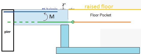

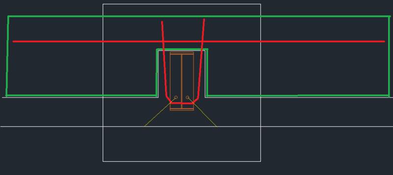

We are working on the old steel building with no original prints available. After contractor removed the old slab, there were hairpin rebars wrapped around column pedestals. I understand their purpose is to provide "some" lateral resistance. Anyone had previous experience with those being damaged/removed and any adverse affects on the structure? How useful are those anyway? It's not like they are going to tie 2 sides of the moment frame together. Control joint are typically cut into interior slabs, so hairpins will rarely tie into more than 1 tile, and sometimes joint are cut right through that rebar. Also, slabs are typically poured last, so those are definitely not helping with any dead weight. I am thinking that single slab tile would add a negligible lateral resistance in comparison to that of the buried spread footing/column pedestal/wall footing.

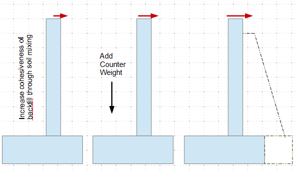

Depending on the demand (calculated as suggested), You can add wall thickness, enlarge footing, or even consider conterfort behind the columns that have lost the connection with interior slab.

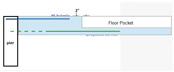

Would that be possible to add a tie rod a ft or so below grade and connect it to the existing hairpins? Ideally top of the tie rod or grade beam would be 4ft deep, but it might be tricky.
I am trying to utilize existing hairpins, as pier reinforcement details and connection to the footing is not known.
I was thinking more of something like that, tie rod can go under the raised floor. It does require a substantial size chunk of concrete to resist the moment M. I like the counterweight, but without reinforcement schedule, wall might or might not resit flexure. Alternatively, the floor pocket wall and its foundation can be designed to resist the load
Yep, thats what I meant. In this case, tie rod would not be necessary. Back of the building is a little trickier though, might still end up with a tie because of that

Here is another idea, what if we cast a reinforced beam right next to the foundation wall and around the pier, so it distributes the load over a larger area of the wall, and prevents a potential concrete failure over 45 degree plane, and it also adds counterweight to resist overturning at the same time
You can do this way (using counter weight). But before make decision, allow me to ask this question - was the original slab connected to the grade beam by rebars? If the answer is "no", you may go ahead. If the answer is "yes", you need to find ways restore the lost lateral restrain that holds the grade beam in place. But in either case, you need to make sure the solution can maintain both sliding and rotation stability of the entire structure (grade beams and column footing).
Okay then. The grade beam was designed as vertical cantilever to handle the unbalanced pressure from backfill. So you only needs to restore the strength of the hair pin at the column. I am more comfortable with your previous idea to engage structural elements directly behind the column, instead of dragging something placed on its sides, because I am not positive its effectiveness to perform duel function - as retaining wall and help restraining the column/footing. But I am not saying it won't work, just needs close analysis to validate its usefulness.

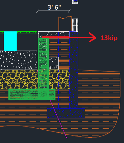

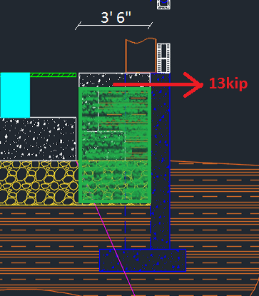

Yes, I think I am more comfortable with a previous solution too. It will work perfectly fine on the left hand side, just like we illustrated earlier. But the other side is supposed to have an isolated slab, so cant tie anything into it and the only space I can squeeze out between the new slab and a wall is only about 3.5 ft wide:
Try go deep. You don't need fill in between, make it solid concrete, and same width as the footing slab. Let's see can it works.

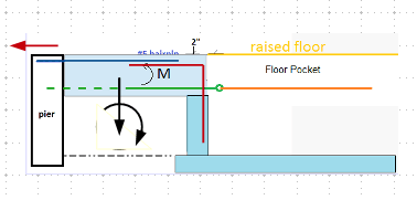

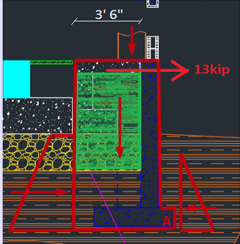

retired13, you mean like a green block on the illustration below? I did try that, and it fails in overturning, unless I make it unreasonably long. Increasing the depth does not really help, unless we rely on additional weight on top of the original footing. But we don't know if original footing to pier connection is strong enough to handle the moment. What we need is to extend it to the left under the slab (2nd illustration), but it might be detrimental to the isolation.
If the 13 kips is the lateral load to be resisted, then the good news is your system maybe not too far off, by taking all loads, indicated in the sketch below, rotate about toe point "A". However, I suspect the bearing pressure might be exceeded under the foot print. Do you have structural engineer who can assist you in evaluation? I am concerned with how the grade beam was designed. It can either be acting as cantilever beam, or the worst, it spans between the columns as continuous beam.

13 kips does not include lateral soil pressure on the retaining wall, it's what the reaction at the column base looks like for the worst load combination. And your hunch is correct, even without lateral surcharge load, its over 3,000 psf at point A.
Looks like the grade beam on this side of the building was designed as a cantilever retaining wall, it sits on the widened foundation, will see if we can find out the dimensions with some minimally envasive procedures.
