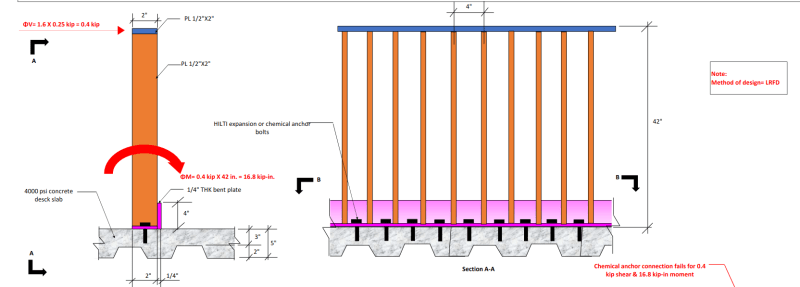

Hello fellow engineers,
AISC design guide 34
I am designing base connection for a guardrail system. I apply 0.250 kips force on the top rail factored with 1.6 (LRFD), therefore 0.4 kips shear force on top rail. The height of my guardrail system is 42". So I get a moment of 0.4 X42 = 16.8 kip-in momnent at the base connection. But for this force, I am unable to design expansion or chemical anchor base connection. The connection fails. The depth of available concrete slab is just 3" (4000 psi).
Please refer to the attachment (PDF) & image depecting the exact scenario.
Could someone please suggest me how to distribute the forces to anchor bolts & how could I make this connection work.
Thanks you.

I am the delegated design engineer. I got confirmation from the ARCH on the looks. It is fine for them. What I thought is, maybe I will distribute this 0.25 kips b/w 2 adjacent guardpickets,i.e., Shear= (0.25/2)*1.6= 0.2 kips; Moment= 0.2*42= 8.4 kip-in. When I check for this load critera, the connection passes (refer below snap). Do you think this load distribution which I assumed is correct?
I think if your governing moment is the point load, and those pickets are spaced that tightly, I don't see why you couldn't count on a couple of anchors helping you out.
I'm not following your loading. Can you change some of the assumptions to help out?
I thought it was 200lb point load applied in any direction? Or 50lbs uniform load per foot? Both of those loads would get hit with the 1.6 load factor.

I'd distribute the load over a 2' width... to engage about 5 or 6 of them... the BAR 1/2x2 is pretty stiff construction. Anchorage cost will 'kill ya'... and you may want to look at spacing them out to 8". Have to watch out for edge distances with the fasteners; they can generate fairly high bursting stresses and add to your notes that torque shall not exceed manufacturer's recommendations.
I would talk to the person paying you. The pounds of steel and welding seem a tad on the high side. I prefer to attach to the steel below. Solves this problem, and it can be put up with the primary steel. I see you have the slab thickness = 5" in Profis. You will need to be clear that they are to coordinate the holes with ribs or make sure you have 5" regions where needed.
With that top rail (1/2" x 2"?), I would think you should be able to distribute the concentrated load over several feet. Calculating the distribution length with the interaction of the verticals is outside my wheelhouse, though.
If you're still having issues with the anchors after figuring a distribution, would it be possible to widen the base to get a larger resisting moment arm?
BridgeSmith... I figured at least over a couple... actually he could space them at 4' and have BAR 1/2x1/2 pickets @ 4" o/c. Anchorage into the steel deck topping may be more problematic.

The information regarding the deck slab which I mentioned in yesterday's attachment is incorrect. It is actually a 12" THK concrete slab w/ reinforcement. So I have enough depth to provide a good 6" embedment. My major concern was only the design of the anchor connection and not the design of top rail or vertical pickets. They are well designed to resist the factored (LRFD)horizontal force (0.4 kip) & moment (16.8 kip-in).
So as @dik said, I thought perhaps distributing the point load (governing load) at every 2'-4" for the purpose of design of anchor connection only. And the connection works fine. I placed 3 chemical anchors @ 12" c/c spacing in a 2'-4" span base plate. The anchors were capable of resisting the horizontal force & the moment. I was able to reduce the no. of chemical anchors too rather than providing b/w every picket (@ 4" c/c).
Please refer to the attachment & let me know your thoughts.

Looks like you are using a rigid body load distribution assumption. What happens to your anchor loads if you choose the flexible FEM-based base plate option in Profis? I’m guessing the outer anchors would have less tension and the central anchor would be greater.
If you have any FEA software you can easily create a model to look at the forces. It took about 10min to model a 48" long region of the assembly using shell elements. So long at the pickets are welded at the base and vertical face of the angle I suspect it is quite stiff. With a 12" slab I would look to use fewer larger anchors.

Be careful when using Profis. Note that Profis distributed the load equally to each of your fasteners. This is likely not be the case and is not a conservative assumption. Don't let Profis tell you how the structure acts - you tell it.
Also, you need to consider your worst case. Usually it's when the load is applied to the very end of a run of rail. The forces might not distribute out nicely like it does when applied to the middle of a run.
Rather than guess at how the load is shared between adjacent posts, I use the procedure in NAAMM AMP 521-12 that distributes the load based on stiffness and number of adjacent spans. Unless your endpost is attached to a wall, it's always going to control since it will never shar much with adjacent posts.
You mentioned the architect was fine with the look. If you’ve got that freedom, you should be able to present a design for them to consider which may be more conventional using intermittent posts, square base plates having (4) anchors, top & bottom rails, steel pickets and a toe kick.
