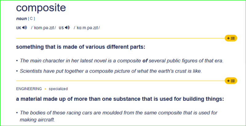

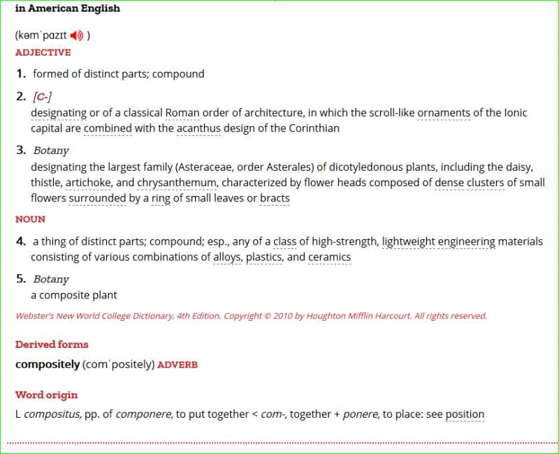

I worded it composite because composite means made of several different materials. One could argue that it is all steel but I argue that yes it’s all steel, but yet different shapes of steel with different properties and methods of producing, so therefore it’s considered composite in my opinion. Composite does not necessarily mean steel/concrete as an earlier reply suggests.

I disagree. Re-read the second explanation by UK, and the 4th (under noun) of the American language. For the former, we need the definition of "substance", we shall read as "a thing of distinct parts, that is any class of engineering material consisting of varies combinations of alloys..."
Somehow I think you would agree that it is an engineering jargon, rather than code defined terminology.
