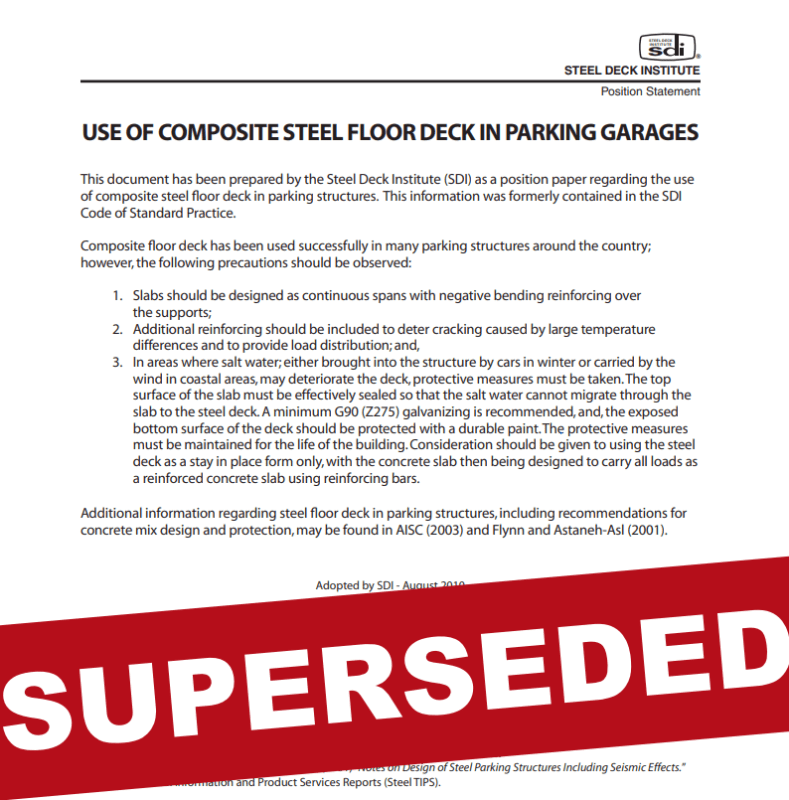

This is/was SDI's position statement on composite deck in parking structures. It's been superseded but I couldn't determine by what exactly. Perhaps, it's been superseded by retracting their support for the concept altogether. Certainly, paragraph #3 creates a daunting impression.
