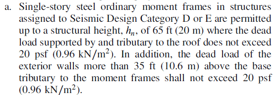

BTW, I'm not looking for solutions or alternative ideas - simply asking if this logic checks out.
The height of the frame is around 45ft. It exceeds the 35ft limit for a multi-story steel frame for OMF. It would change the architectural look of the designer's ceiling to do a SMF all the way up and deal with bottom flange bracing on the top beam at the roof. We want to avoid Simpson's specialty product that doesn't require bottom flange bracing. So, can we do an OMF on a SMF (we can do bracing at the floor level easily) that share the same columns? Obviously the R of 3.5 tracks into the SMF, but the goal here is to fall underneath the provision of a 65ft single story OMF by having it stack on an SMF, and avoid bracing on the top beam. Does this logic check out?
Deker said:
To qualify for two-stage you do need flexible over stiff. Not likely the OP could qualify with the proposed system
Okay, I guess that you've been assuming that OP meant for the SMF to be stiffer than the OMF. I've been assuming the opposite. I guess that it would depend on the drift limits applied to the two stories. I'd just assumed that, because the lower story was designed to yield and the upper story was not, that would make the upper story the stiffer. I can, however, imagine situations where that would not be tre.
That's a horrible idea. What time?
YoungGunner, I think we're all clear on what you're trying to accomplish. Since you are showing two beams, I presume this is a 2-story structure. Correct? If so, you cannot apply the 65 ft height exception for OMF because that only applies to single-story structures. A shorter height limit applies to two-story structures, which you exceed.
What we're telling you is that in order to justify what you are proposing, you would have to perform (and qualify for) a two-stage analysis so that you could apply the building height limit to the upper frame only. While that would technically be code compliant, it's not how the code is meant to be applied. See the article I link above.
Not sure what your constraints are, but there is a way to achieve SMF bracing with an adjacent HSS member that is parallel to the beam without introducing bracing members back into the plane of the diaphragm. See page 26 of this document: Link.
What exception exactly are you attempting to use?
My thought is that whichever one you are referencing contains some language that prohibits what you want to do.
The only reasonable conclusion about your system to apply towards these exceptions is: you have two story structure, and the height is 45 ft.
Allow me to shed some light on the ASCE wording. With this wording, it is not the structure that needs to be single story, it is the OMF. I'm just trying to create a single story OMF on top of an SMF, all within a structural height of 65ft.

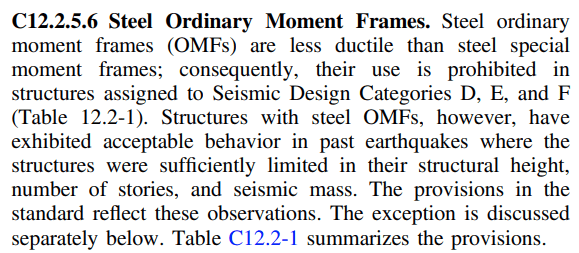

Adding in the ASCE commentary about this topic as a reference. They just provide justification based past performance. I agree with your thoughts and don't have much to add to it, if any.

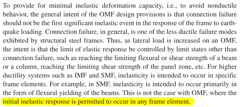

Re: the stiff portion on top of the soft portion - in that sketch wouldn't you hinge the columns first? Maybe some way to consider the top story as equipment, but I'd think you're applying overstrength factors or forces equal to member yield to the soft structure, so not too much different than dealing with the soft story irregularity.
Oooo I just had another thought - OMF don't have a specific hinge point. Theory is you just provide strong connections so those don't break, and any point of the frame will yield - including the columns. With that backdrop, I think it's scary to allow for hinge points to develop in columns for tall structures.
@Younggunner - Starting to understand where the confusion is coming from. It does say 'Single Story OMF' it isn't clear whether it means 1 story of many can be OMF or if the whole structure has to be 1 story or less.
Looking at that C12.2-1 Table seems to me to suggest that even though the wording in the exceptions is slightly different, the intent is that the structure has 1 story max. I could be mistaken about this however.
I believe part of the height & story limitations in ASCE 7-16 is to provide well proportioned distribution of the ductility. And it is exactly that ductility which I would be concerned about if I was going to accept your reasoning that the OMF is allowed because it is only one story.
The determination of the story drift I would be especially interested in. Essentially you want the beam of the SMF to hinge at the same level of seismic load as the OMF beam and you need the story drift to be within limits for both floors.
The Cd factor and R factor for the SMF is based on the detailing, lets say you did a reduced beam section, well just because you use Cd from the OMF above, does that really mean you will get that much drift, or perhaps more because of the physical shape of the beam?
But the Cd and R factor for the SMF would match that of the OMF. Yes, in complete theory, this is really just an OMF with SMF connections on the lower half. In which case, I guess you could say it is just an OMF that uses option (c) of AISC 341 E6b, where you match the detailing of an SMF. So in that logic, I guess this still stands as a two-story OMF either way.
That table in the commentary is interesting to see, though it doesn't clarify whether that is the max number of stories of the structure or whether it's the max story of the structural system, though in context with everything else we could say single story structures.
I feel that is something that is designer controlled. I'd be expecting the designer to enforce some version of strong column - weak beam.
In general we do not allow hinges to develop in our columns. That's the whole "strong column / weak beam" thing. The major exception is roof beam to column joints where column hinges are often allowed. It's okay in that situation because, presumably, the roof level alone would not weigh enough to create a big P-delta demand and pancake that story. It can also be quite impractical to try to enforce WBSC where there is no upper column coming into the joint.
I don't agree although I admit that it's a point of confusion both for me and in the literature. I believe that OMF are expected to yield in the same places that SMF and IMF are typically expected to yield. The difference is that the amount of member rotational ductility required is kept low enough that it doesn't require special attention.
I refer to the commentary of AISC 341 for my thought process for OMF, though after a re-read it becomes more clear that inelastic behavior is not encouraged in an OMF, though there may be some.
