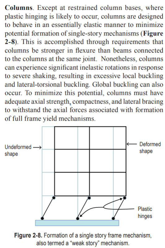

When I consider Strong Column / Weak beam, I visualize the sketch show below, taken from one of the NEHRP seismic design guides. The goal is to prevent all of the columns within one story from forming plastic hinges that would cause an individual story to pancake. This is critical during a seismic event, not just after a seismic event.
There... now you go.

The image in your last point is more about soft story issues than it is about moment ratio. I should point out that if those columns only hinged at the base then this would actually be FINE for a SMF. In fact, I think column base hinging is a reasonably common form of column inelasticity.

The strong-column weak-beam (SC/WB) concept is perhaps one of the least understood seism provisions in steel design. It is often mistakenly assumed that it is formulated to prevent any column flange yielding in a frame and that if such yielding occurs, the column will fail. Tests have shown that yielding of columns in moment frame sub-assemblies does not necessarily reduce the lateral strength at the expected seismic displacement levels.
The SC/WB concept represents more of a GLOBAL FRAME (my emphasis) concern than a concern at the interconnections of the individual beams and columns. Schneider, Roeder, and Carpenter showed that the real benefit of meeting the SC/WB requirements is that the columns are generally strong enough to force flexural yielding in beams in multiple levels of the frame, thereby achieving a higher level of energy dissipation.....
It should be noted that compliance with the SC/WB concep and equation 9-3 gives no assurance than individual columns will not yield, even when all connection locations in the frame comply..... Nonetheless, yielding of the beams rather than the columns will predominate and the desired inelastic performance will be achieved in frames sized to meet the requirement.
