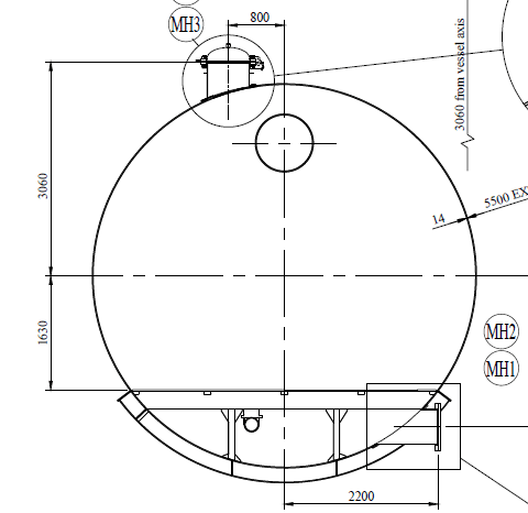

Received some pressure vessel drawings, having following data
ASME Sec VIII Div.2
Dia: 5500mm
Lenght: 20200mm
Thickness: 14(Shell) / 10(heads)
Hemispherical heads
supported on 3 saddles.
Vessel have internals of more than 20000kg
Although design is not in my scope of work, just curious to know, is there any guide or method to calculate these kind of partial stiffener rings (24 rings shown in drawing)?
I have checked myself, and without these partial stiffener rings, vessel design fails due to high circumferential stresses at tip of stiffener.

Geoff13: Not directly. There rings are outside the vessel. But it seems, these are surely to manage longitudinal stresses. Following drawing will better explain the schematic.
Saplanti: You can see the internals in following drawing. There is a perforated 20mm plate covering the entire area in vessel, supported by vertical supports and I-Beam structure.
r6155: I will check it again, because when i checked this last time, based on div.2, it was failing at saddles.
This drawing explains better. In this configuration I would extend the external partial stiffeners to 150 degrees, (as it is, it looks like 120 degrees) for hand calculations only to take the weight loads to side walls on shell. This will reduce bending stress in the stiffener edge and shell connection. The existing concept may work if proven by FEA.
The centre saddle with circumferential stiffener will take the highest vertical load, perhaps the half the vessel load. When you are doing the saddle calculation you need to consider the circumferential stiffener effect into consideration. This will reduce the bending stress at around the ridged.
It has nothing to do with longitudinal stress. I would have thought it would be more economical to use a thicker shell than so many external stiffeners.
1) Stiffening rings complicate manufacturing and inspection. Surely the welds of the rings (continuous or intermittent fillet?) will produce deformations in the cylindrical shell and generate residual stresses. They may have to perform heat treatment for stress relief.
I insist: 2 saddle supports and not stiffening rings.
2) Are you sure that SA-516 is good for sea water?

They are also not UG-29 stiffener rings. As Geoff13 suggested, they are for load distribution into the shell. However, at less than 1 Tonne per stiffener, with 4 points of support on the shell, you are talking about a relatively low load. It is a small fraction of the weight of contents. I agree with r6155, generally two saddle supports would be recommended, and with a suitable increase to the shell thickness, this should be possible. Would be far more economical than an extra saddle support and 20+ stiffeners.
Internals welded to the shell act as reinforcement.
