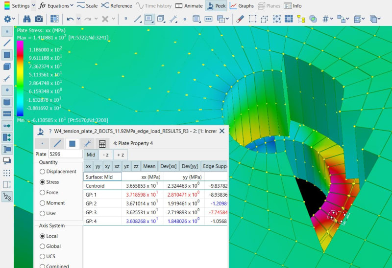

Hi Doug,
I have actioned your comments and re-run the model with only one load factor. Please find attached.
As asked above, I can view the plate contour stress results, but would like clarity on how to view the tensile and bolt bearing forces (is this possible in this model?). I would like to understand what result will show the tension loads across the plate, as I understand the in-plane axis for the plates is x & y, so do the xx results, yy results or the xy results showe these stresses?
Thank you!
Gavin
 https://files.engineering.com/getfile.aspx?folder=d73703c4-48ce-44a4-a6d6-70531ddce483&file=W4_tension_plate_2_BOLTS_11.92MPa_edge_load_RESULTS.st7
Gavin - I have attached a screen-shot of results from your file. I am using Rel. 3, so some things will look a little different in your versionm but the important things should be the same:
The main things to note are:
1. Set the plate display to "solid" so they look like brick elements.
2. You can set selected elements to not display, or alternatively set only selected elements to display, so you can make elements transparent that would otherwise hide the elements you are interested in.
3. You can also hide or display selected properties, or assign elements to different groups, that can be displayed or hidden.
4. The "peek" tool gives you detailed results for a selected element.
5. You can also select one or more elements, then select "display selected elements only" in the text based results listing view.
Regarding the validity of the results you are getting, analysis of bolts in steel structures is really outside my expertise. If you have specific questions it would probably be best to start a new thread in an FEA forum, not referring to a specific analysis package, which should get more response from others.
If you have any other Strand7 specific questions, feel free to post here and I will be happy to have a look.
Doug Jenkins
