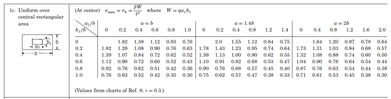

Our good friend Roark has and answer for this. From Roark's Formulas for Stress and Strain:
(for a simply supported plate 4 sides, with 'a' as the long side. In your case you'd be looking at the far right hand table as a>2b is effectively simply supported 2 sides)
