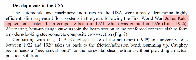

HouseBoy - Sorry for any confusion I caused. I was addressing the OP's question, but failed to say so:
pittguy12 said:
Does anyone know if composite beams were used? If so, did they utilize something other than studs or coils to transfer the load?
From the attached paper, in the USA, here is the one and only worthwhile step towards development of satisfactory composite construction during the 1920s:
Well, here is Mr. Kahn's patent.
If the OP wants to go on a wild goose chase... do some exploration in the slab looking for the "bent-up flange cut-outs" shown in the patent.
If the detail does exist in this house... be sure to submit this house for inclusion as an ASCE Historic Landmark.

In the early development days of composite beam (a clip from paper linked above). Shear connector was invented/used in the later date as pointed out by SRE.
Another example is Mathias Koenen’s (1849–1924) flat-soffit, later (from about 1892) ribbed, floor in which the underlying steel sections carry the tension and the arching concrete infill sections are solely responsible for carrying the compression. Despite the lack of shear connectors, tests confirmed Koenen’s assumptions regarding the structural behaviour (Christophe 1902).
