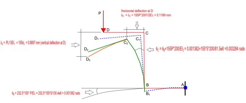

BA do you agree with this ? In the horizontal defletion SD=SC=155P*200^2/2E1 why is E1 It shouldn't be E2?
In the vertical defletion the term PL^3/3E1=5*310^3/(3*130.4e6) could you explain?

BA do you agree with this ? In the horizontal deflection SD=SC=155P*200^2/2E1 why is E1 It shouldn't be E2? Yes indeed! Good catch!
In the vertical defletion the term PL^3/3E1=5*310^3/(3*130.4e6) could you explain? Yes. That is the cantilever deflection of a beam with span of 310mm and stiffness of EI1. In addition to that, are the effects of theta B and theta C which, at the time of writing, could not include an expression for joint rotation. Since then, I have been toying with expressions to include an approximation to account for the flexibility of Joints B and C but so far, have not been entirely satisfied with the result. Unfortunately, I am not well versed in Finite Element Methods probably more familiar to mechanical engineers.

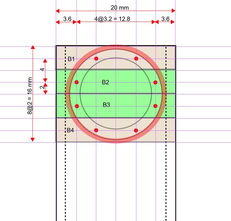

It's getting late and I'm bushed. I thought I would tackle the stiffness of Joints B and C using beams B1 to B4 as shown below. The thick red circle represents weld metal. Each beam is 4x1.5mm in cross section and is continuous around the corner of the hollow section. The red dots are loads from the circular section carried be each beam. B1 and B2 carry the same load as B3 and B4, but in the opposite direction.
I tried to use Yield Line Theory, but couldn't seem to come up with a believable arrangement of yield lines. If you have a program which can analyze these loads, let me know, because I don't particularly want to spend a lot of time developing a solution which will not be used. Otherwise, I will have a go at it tomorrow.

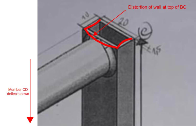

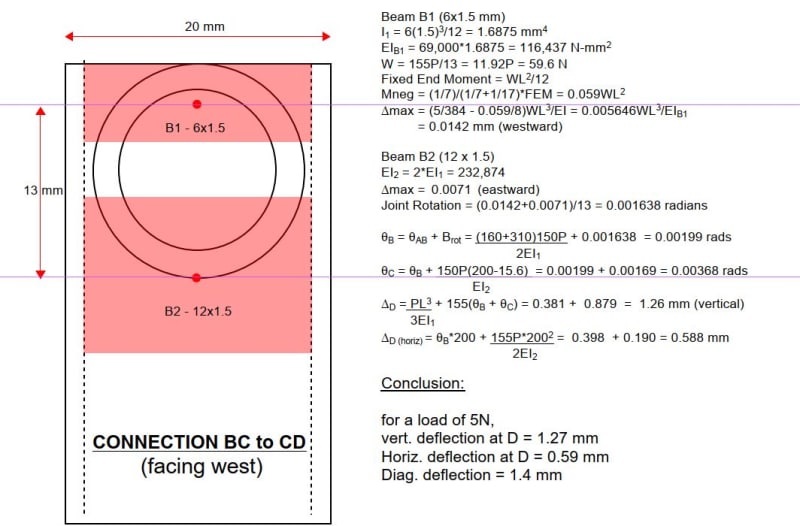

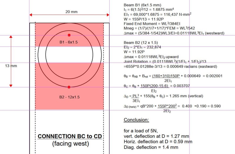

Shown below is a sketch of the connection at Joint C. Joint B is presumed to be similar. The deflection at Point D appears to be in reasonable agreement with measured deflections when the Joint rotations at Joints B and C are included.
WOW ! ... measured deflection (for 5N) 1.49mm !! WOW ...
but is this effect non-linear ?
It should be linear until the tube wall develops stresses above the yield point, which does not require a very high applied load. I suspect that when P exceeds 20 or 30 N, non-linearity would start to show up.
The lesson to be learned by this experiment is that tying into the wall of an HSS does not always develop the full strength of the HSS.

I noticed some errors in my last post. Please ignore it and refer to this post instead.
