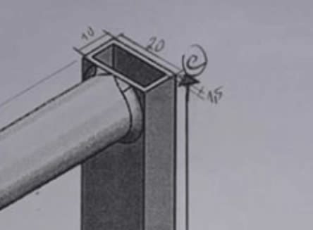

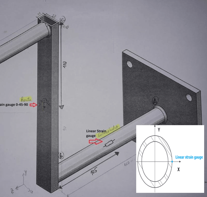

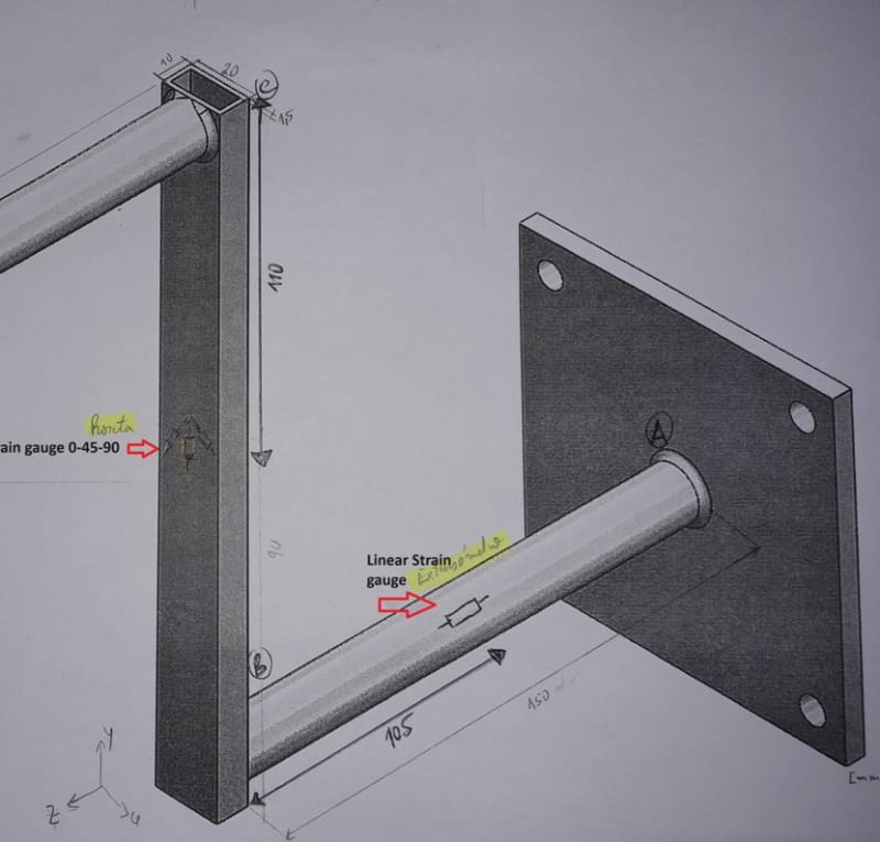

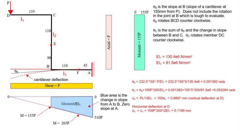

Hello, I need some help about this project. I need to calculate the internal forces and moment, normal stress and shear stress in the 0-45-90 strain gauge and for the linear strain gauge. However, I have doubts, especially how to calculating the shear stress and whether the internal forces are correct.
So i could make a mohr circle with the corret values. Thanks.

For tube BC:
I=(20x10^3-17x7^3)/12=1180,75 mm^4 (the tube its 20x10x1,5 mm)

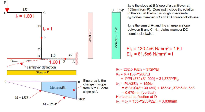

I found the vertical and horizontal deflection at D to be 0.679mm and 0.038mm respectively (see below). I haven't checked it yet, so it may contain errors, but perhaps it provides a basis for further discussion.
Joints B and C are flexible because the circular tube is connecting to the thin face shell of the rectangular tube. Joint rotations at B and C are not included in my calculations above. They are hard to predict, and they will increase both the vertical and horizontal deflection at D.
One solution is to change member B-C from a hollow tube to a rectangular plate having equivalent strength and stiffness as the tube. Members A-B and C-D can be butt welded to B-C, and the measured deflections should be in better agreement with calculations.
bd3/12 = 1180.75, so d = (1180.75*12/20)1/3 = 8.915mm
A plate 20x9mm could be used for B-C, if it has sufficient strength for the forces to be applied.

I experimentally obtained from the dial indicator a displacement for a load of 5 N of 1.491 mm and for 7 N of 1.931 mm.
My difficulty is how to arrive at a value close to these values, analytically and I don't understand how.

BAretired could you explain how do get 232.5 value on tetaC. Theta B, but theta C is equal to theta B plus the slope of BC. Assuming a fixed end at A, the change in slope from A to B is the area under the curvature diagram, M/EI1. 232.5*P Is the average moment between A and B. Its area is 232.5P
You can make a sketch of what each calculation refers to as I did in the diagram. It's hard for me to understand. I'll try, but this is getting to be a lot of bloody work.
I experimentally obtained from the dial indicator a displacement for a load of 5 N of 1.491 mm and for 7 N of 1.931 mm. 1.491*7/5 = 2.09 (8% higher). So measurements can be in error.
My difficulty is how to arrive at a value close to these values, analytically and I don't understand how. No problem! You'll be an expert by the time we're done. I will try to explain in a separate post.
You say, that Joint rotations at B and C are not included in your calculations above. Do you think that you have considered, the final value would be closer to 1,491 mm to 5 N? Well, they will certainly be headed in the right direction, but I have not done the calculations yet, so cannot confirm your value.
And the rotation at A, have you considered? The rotation at A is taken as zero. I know there is no such thing as a truly fixed end, but a cantilever is normally assumed to have zero rotation at the fixed end.

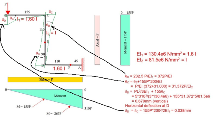

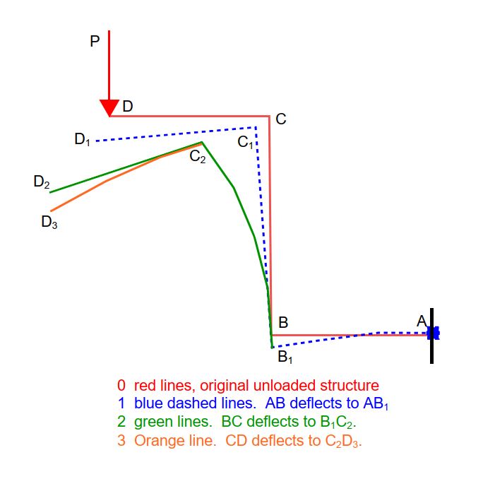

Below is a further explanation of the rotation at B and C.
so AB deflects to an arc, so thetaB develops.
BC is fixed to the end of AB, so C rotates about B (and maybe include the compression shortening of BC since this is a school problem; yes BA, we'd probably neglect it in the real world),
and CD deflects (similar to AB)

There are several methods for finding slope and deflection. The Moment Area method and the Conjugate Beam method are easy ways of finding both slope and deflection in a straight beam, but can easily be adapted to your Z-shaped structure.
The area under the curvature diagram, i.e. M/EI diagram between any two points x1 and x2 on a straight beam turns out to be the change in slope, in radians, between those two points. Since A is the fixed end, its slope is zero, so the change in slope between A and B is also the slope at B. The area of the blue trapezoid in my last post is thetaB.
I encourage you to review the two methods I mentioned. If you're still having trouble understanding my calculations, let me know. By the way, I still have not checked my calcs, so there could be errors. They need to be thoroughly reviewed. EDIT: I think I just found an error in theta B...omitted the length 155...the fun goes on.

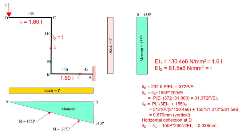

I have reviewed my file and found some numerical errors. The revised calculations follow:
Hopefully these are correct, but the results are still less than the measured deflection. Stiffening Joints B and C would move us in the right direction.

BA I was checking your calculations, however I still have some doubts about how you arrived at some equations. Can you check if the sketch I made corresponds to the displacements and slopes?
Why thetaC is the sum of thetaB and the change of slope between BC? Shouldn't be only the change of slope between BC?
In the second page i make how to get to equations of thetaB and and thetaC, could you check if looks correct?

By the way rb1957, one question, if the linear strain gauge is on the x axis, analiticaly the stress sigma x=0 , wichs fits right, correponds to the -0.229 [Mpa] and -0.478 [MPa] for 5 and 7 N experimentaly obtained it is correct?
Before we get into a discussion on numbers, let us agree on how this structure behaves. The diagram below may clear things up. Then we can look at the numbers.
"By the way rb1957, one question, if the linear strain gauge is on the x axis, analiticaly the stress sigma x=0 , wichs fits right, correponds to the -0.229 [Mpa] and -0.478 [MPa] for 5 and 7 N experimentaly obtained it is correct?"
I don't understand why you think the s/g should read zero stress ? The top CL (where I think the linear s/g is) should be responding to the bending in the tube. Using the directions you defined in the OP, the s/g responds to Mx, but not to My ... yes ?
I understand butt the linear straing gauge is on the x axis position. So responds to bending moment butt analiticaly is zero.
Mfx=265*P
Analiticaly Sigma x= (Mfx*y)/I=(265*P*y)/I)=0
The Experimental value that obtained for 5 [N] of -0.229 MPa and deformation of -3.330 us shows that is reading close to zero, wich fits right with the analitical sigmax=zero
do you agree?
Because to take experimental results i used directly hooke's law for calculating stress sigmax=Deformationx * E so for 5 [N] sigmax =-3.330e-6 x69e9=-0.229 MPa.
For the strain gauge position, in this case i dont have sigmay ,only sigmax=zero, do you agree?

& BA[/color]]BA I was checking your calculations, however I still have some doubts about how you arrived at some equations. Can you check if the sketch I made corresponds to the displacements and slopes? It's too washed out to get a good read, but thetaC is totally wrong.
Why thetaC is the sum of thetaB and the change of slope between BC? Shouldn't be only the change of slope between BC? Why would you say that? For that to be true, member AB could not have deflected at all. When AB deflects, B goes to B1 and C moves to C1. Then when BC deflects, C1 goes to C2 (the green line in my diagram.
In the second page i make how to get to equations of thetaB and and thetaC, could you check if looks correct? Our value for thetaB agrees. I can't read your comments about thetaC. If you want me to check any more of your stuff, type it out. I'm 90 years old and my eyes cannot take the strain of reading such terrible handwriting. It is not only bad, it is washed out...too faint to read.
Experimentaly i obtained for 5;7;9 [N] 1.491; 1.931 and 2.762 mm of displacement. Okay, I knew about the first two, but not the last result. It seems to be in fair agreement with the 5N test.
Now for 5 [N] a total displacement of (1.00868-1.491)/1.491 is has an error from 32.3% which is bigger than 20%. That is not surprising, as you are ignoring the joint rotations at B and C, and possibly A.

ok ... very badly drawn sketch ... to be on the x-z plane it should've been on the transition from white to shade ... maybe only a small detail, but this is all we have to go by. as drawn it might be on the y-z plane (where I thought it was), or maybe at the 45 degree position. Why would you run a lab expecting a zero result ??
instead of zero you get a small stress ... ok, maybe the gauge axis isn't perfectly aligned to the AB leg ?
maybe this is the point of the lab ... how real are our idealisations (like a fixed end), how could a small reality affect the results, how could a small imperfection in the set-up (the s/g axis) affect the results ?
