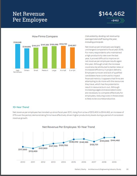

Aesur, not sure what market you are in, though assuming USA. If your firm is only billing out 150k per year per working engineer on staff, no wonder you're growing rapidly and picking up work in other states!
Assuming the engineer bills out 1800 hours per year, that's only a billing rate of 83$/hour. Even students in my last company were being billed at 100, fresh grads 125, mid level engineers 180, senior level guys 220... Etc etc
NorthCivil, the market I'm in is very competitive with lots of firms outsourcing to other countries, we can only dream of those higher rates. We are actually billing out higher than that and we adjust our fees based on the specific market/type of work to keep from undercutting others, while still being competitive. We don't want to be the reason other engineers suffer or lose their good fees in the higher fee markets. That number is the average per a survey across the USA last year. I will see if I can find that survey again to post it. Part of why we are expanding to other states is to get access to better markets, this one is too saturated, but we had many connections here so we started here. Additionally, once factoring in vacation, sick time holidays, training, etc.. the typical billed hours is closer to around 1500 hours max, and this doesn't account for overtime nor going over on projects with newer engineers. You cannot just get a higher fee because you are using a project to train a newer engineer.
NorthCivil, I should probably add that based on the numbers you posted you have to keep in mind that mid level engineers are probably 65% billable and senior level probably closer to 40 to 50% as they are typically the project managers and principals responsible for obtaining work, few senior level guys actually bill out at those rates because almost every project would exceed the budget significantly at those rates. For most companies utilization rates are in the 55 to 60% range because of this. The report is the Deltek A&E report, per the 2020 report net revenue per employee is 144k, the report can be viewed at: Link.
