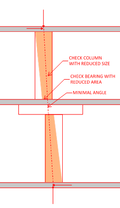

for offset columns, I always find that if possible, it is best to ensure that the area of which the two columns overlap should be designed to resist the load, although you likely do not have that luxury in this case. Trying to use the slab to resist the moment caused by offset column, as you can see clearly from KootK's S&T diagram (which I agree with), is inherently inefficient.
One of my preferred ways to transfer column is to do something like this instead:
