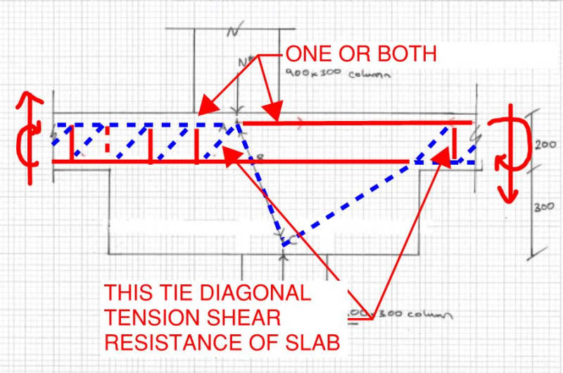

I have been a long time lurker on eng-tips and have finally found the need to make a post for myself.
I have recently become familiar with Strut & Tie modeling and am currently faced with designing an offset column attached below. I have tried designing without a drop panel and my tie forces were far too high so added the drop panel in to increase the angle between the strut (black) and the ties (red). I know it would be ideal to have my bottom tie at node C however we do not detail reinforcement in the bottom of our drop panels at our firm.
I am wondering if my current model is reasonable (or even possible) with node B being midway through my strut. Am I missing additional struts or ties? Is this even a Strut & Tie problem or can I use standard methods of analysis? I am having trouble finding the resultant tie forces as I get different results when using the sum of all forces/moments or using simple trig so I'm assuming I am missing elements somewhere.
Any help would be greatly appreciated. Thanks.

If you get rid of the drop, the lines probably end up as a jumbled mess on the ground after the compression failure in the columns. There needs to be sufficient depth to make sure that the compression can distribute over the full width of the column assuming the full column dimension was needed in the first place. Usually based on about a 30 degree angle of distribution.
Otherwise you end up with something like what happened with the Opal building in Sydney (one of its many problems)!
Rapt, are you referring to my question in the 5th post in this topic? I thought if you got rid of the drop then you could get rid of all the ties too, suggesting the problem had been over-simplified.
steveh49.
Yes, that comment and KootK's reply.
The drop is not causing the need for the ties. The eccentricity is. I do not think S/T can give a solution in that case either, but you still need sufficient depth for the load transfer.

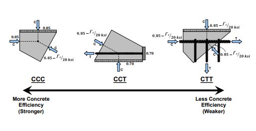

steveh49 said:
This is an implicit requirement of S&T design. CCT nodes have lower capacity because there is tension in one direction which 'activates' the tie. The opposite of the strength increase when concrete is confined with transverse compression.
I agree with that wholeheartedly and I'm glad that you mentioned it. In a similar vein, I see the situation as analogous to the middle case below. It was never my intention to suggest that, for the purpose of nodal compression efficiency, the node should be treated as CCC. I was merely trying to explain how I visualize the load path in these situations such that one would not need a four member node in order to account for resistance coming from both the tension and compression sides of the node. In retrospect, however, I can see how my statements implied full CCC node treatment so, in that respect, I'm grateful for your clarification.
I'm not sure if I'm interpreting the statements of others correctly on this front but, one thing that I would not agree with, is any opposition to the use of STM for this condition. In my opinion:

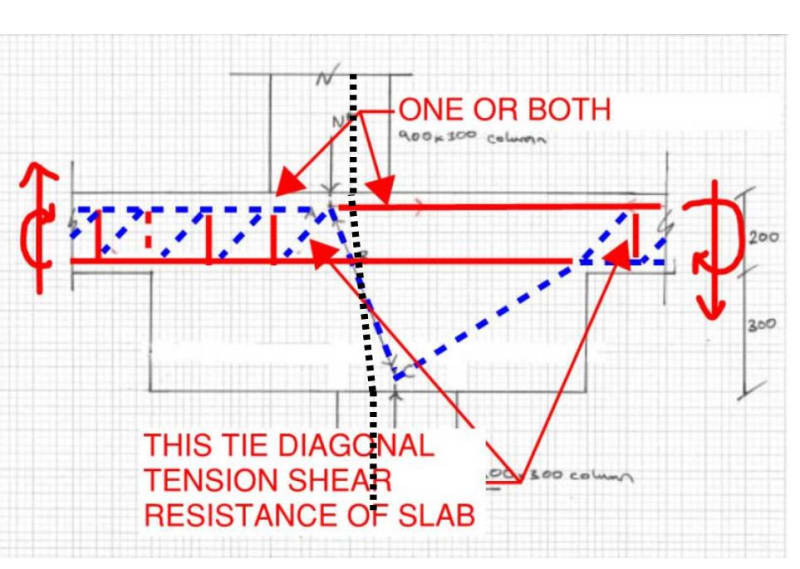

Ar Engineer's original post said it could not work without the drop as the tie forces are too high with a 200 thick slab. What he has not check is vertical force transfer through a 200mm depth which likely also fails.
Adding a drop does not reduce the tie forces required to produce the same moment couple at the face of the drop, so the tie forces are still too high.
Adding the drop adds requirements for vertical ties in a 200mm thick slab.
The rotation required in a 200 thick slab to generate this tension/compression force couple would be enormous. All the drop does is move it to the edge of the drop and introduce an upward component of force at the edge of the drop that causes more rotation if that is possible.
The drop needs to extend the full length of the span either side to give it a chance of making the design work.

Kootk, in all honesty, your analogy made me think for a moment that I could consider all CCT nodes as CCC. I decided, however, to stay on the conservative side though and stuck with CCT.

In your case, 10N32's is equivalent to 4000KN. How could your concrete strut transfer that? Assuming a generous half depth of the slab and a 1000mm width that gives you 40MPa concrete stress at the node.
RE Punching shear, it would depend on how much overlap there is. The big worry for me in your case is the compression stress in the columns. If you had the case with only the slab and no drop panel, the compression needs to transfer from the column above to below. It will distribute at about 30 degrees to the vertical, so if that is the 300 dimension of the column we can see on the drawing, then only about 250 * 900 (from 300 / 2 + 100) of the full column width will be taking the full compression. If it is the 900mm dimension, then only 500 * 300 (from 900 / 2 + 100) of the column will be taking the full load.
So if your column is working hard at 900 * 300 it is working a lot harder on the reduced dimensions. And the rotation you are getting to make the S/T work, there is a big moment induced in the column as well!
Yes, the overhang part could try to punch through, especially if you have compression problems in the column below, and a lot of rotation due to the extreme flexibility of the slab providing the S/T transfer.

I am talking about the compression in the bottom of the slab forming the compression part of the moment couple in the slab.
Rapt,
I see the issue now. Would I be able to consider bottom reo to take some of this stress? Either considering the reo within the strut or by adding a horizontal tie to the left of that node as KootK has shown in his sketch?
Steveh49,
No, the architect claimed they needed the offset to get their kitchen layout to work, which apparently was more of a priority than the structural requirements of the building... must be a new code clause?
In terms of the prismatic strut, if my column over and column under are the same dimensions can I not assume my bearing area/node width is the same and thus my strut will be prismatic?
KootK has shown a diagram of possible strut forces. You have to dimension the struts to take these forces and transfer the forces to different struts at nodes. There is a an angled compression strut from the bottom to the slab at the right. You have to dimension this strut to meet the strut in the slab and make sure the compression stresses are ok. That is before anything gets into the horizontal struts in the slab.
Then when it goes into the slab, stress in the compression reinforcement will develop over a length, it does not happen immediately.
RE you last question, you cannot assume anything. Work out how the forces can transfer through the concrete over the depth available.
Wherever you have a significant mass of concrete available in the slab opposite the tie, you surely could consider the nodes as CCC via one of two options:
1) Just ditch the tie entirely and say that the strut leans against that opposing concrete. I suspect that this is why most of these things tend to work in the first place. Certainly, if it's me though, I'd be tossing in the tie for good measure anyhow.
2) You could de-bond the tie over the width of the crossing node/strut. In that way, you retain the nodal efficiency of a CCC node and the node and strut would just slide past the tie. I've never heard of anyone doing this but I don't see why it couldn't be done. Similar things are done in the world of precast regularly.
